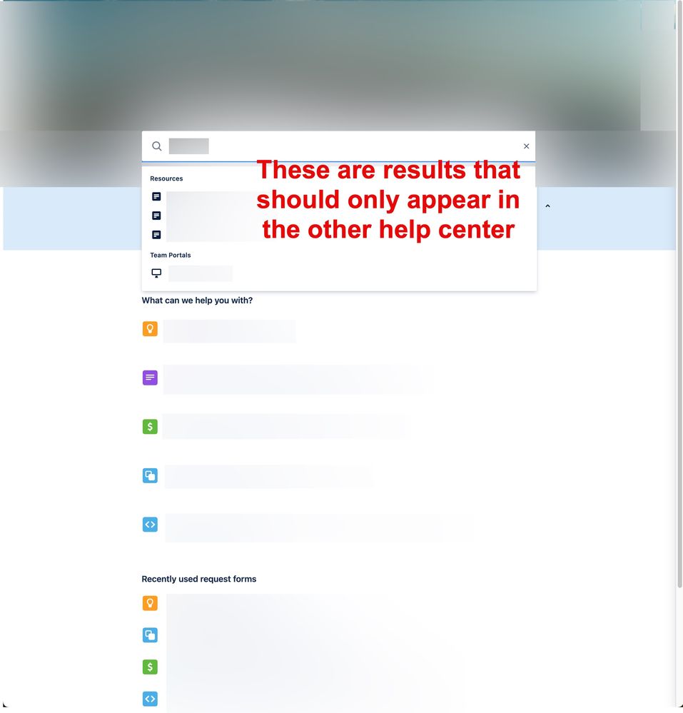

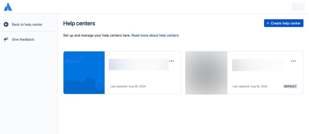

I do have 2 Contact Centers
Apologies for the heavily edited image, gotta keep the security team happy. But I hope this showcases the issue a little better. The issue from the image below is happening to both my help centers.

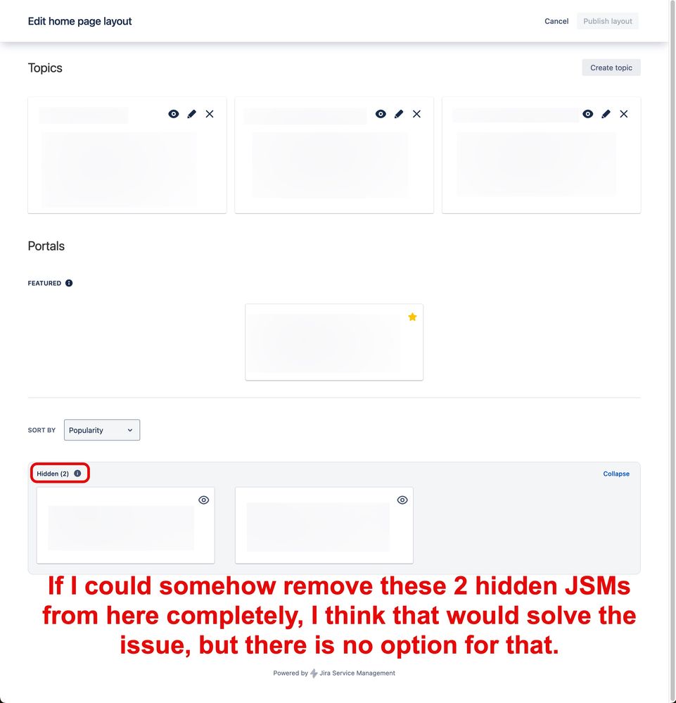

One last thing I noticed.
There seems to be no way to completely remove a JSM project from a help center, only hide it. I think this is where the issue lies. If I could totally remove a JSM project from a help center rather than just hiding it, I think the issue would be resolved. However, I don't see an option for this at all.
Example:
Hope this helps.
Thanks!

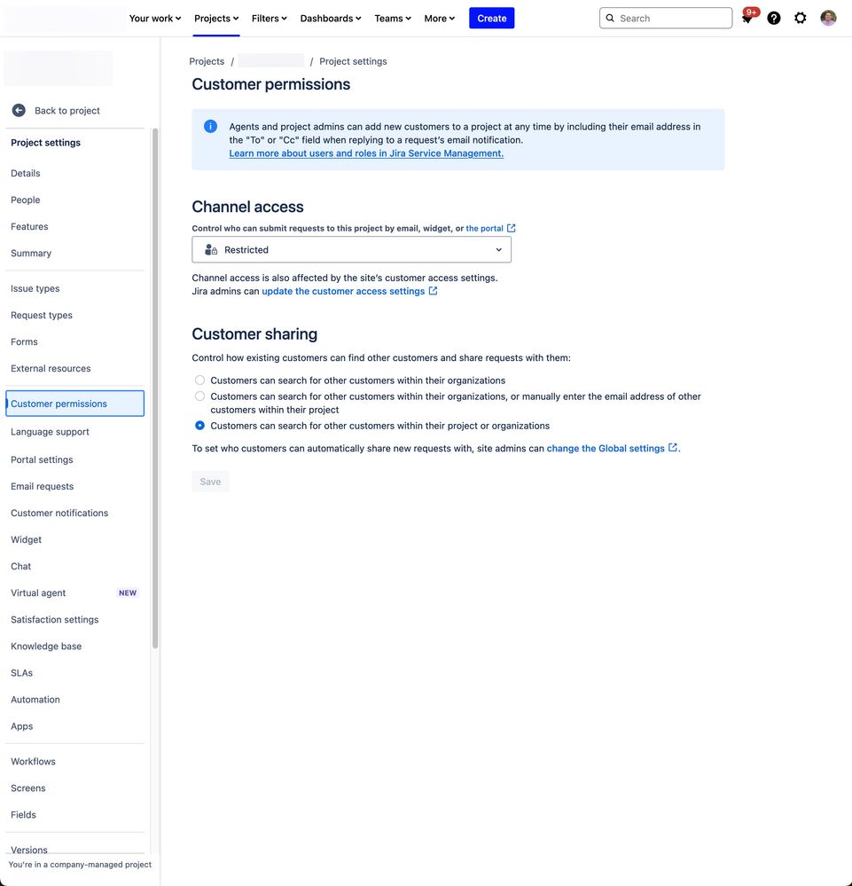

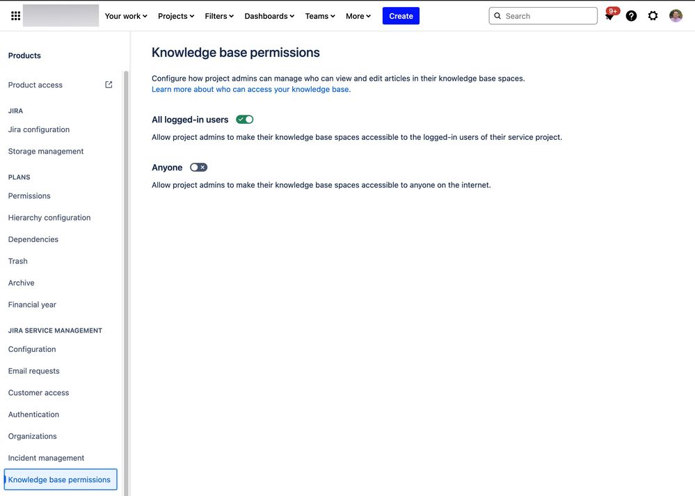

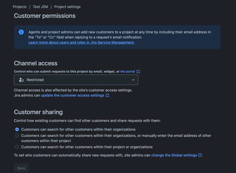

Here is some additional info

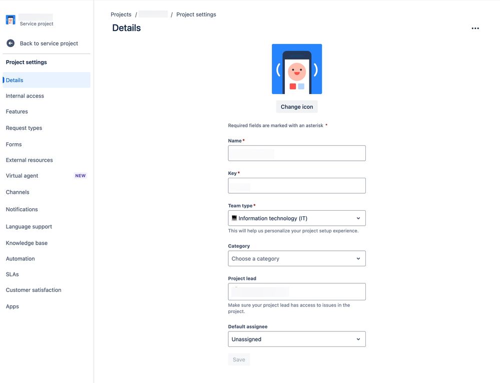

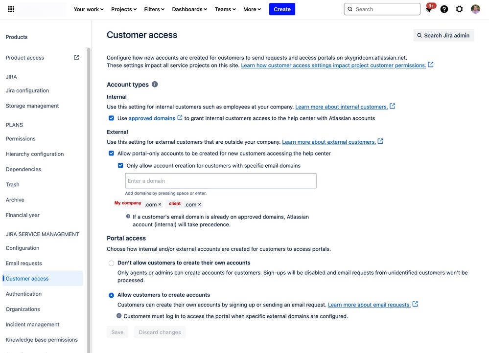

First, the screenshot below is from the JSM linked to the company's internal support. It's a team managed project and doesn't allow us to set customer permissions. This has been working just fine for internal support.
And below, here are screenshots from the portal I am configuring for external support.
With these settings I am aiming to have both Help Centers completely separate from each other with 0 overlap.
I know for the knowledge bases the content visible on the Help Centers should use the same restriction settings from Confluence. So if I don't allow external access to the internal knowledge in Confluence it shouldn't be visible to external clients. But it doesn't seem to working that way.
____
I had a colleague with a different domain access the client facing portal yesterday, and just by altering the URLs they were able to see the request forms from the internal help center. Unsure how this is happening.
I hope the images shared above explain the issue a little better. I will be conducting more testing and will share the results.
