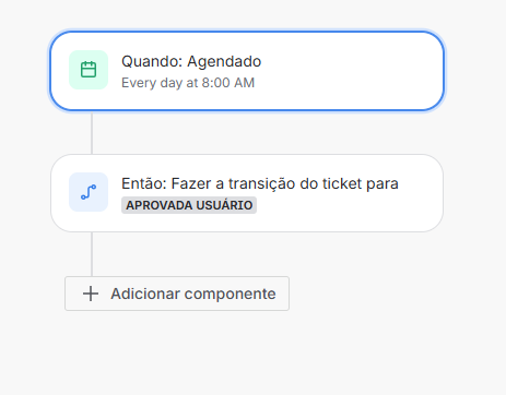

And the rule is set like that:

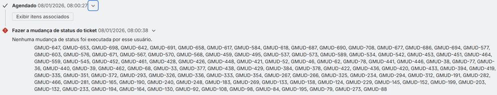

In the log file I've got this:
This means that no transition were made.

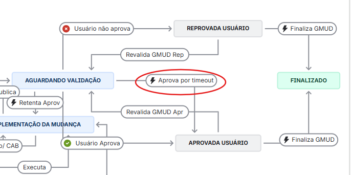

1- yes, there is a transition to move to the B status.
2- The status "Aguardando Validação" is waiting for Aprove (the validation = Validação), because of this I created another transition to make it possible to execute the transition.
The red circled transition was created to make this transition and avoid blocker due to Aprove/Reprove.
3- The actor is the Automation for Jira, I'll double check this point.

Hi Jader,
2 - Did you check whether there is a condition/validator on the "Aprova por timeout" transition?

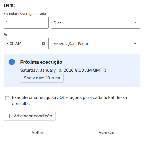

Hi @Jader Peixoto Volkmer
Disable the checkbox "Executa uma ....."
As you JQL finds issues not updated in 30 days in a certain status.
If that checkbox is enabled only issues updated since the last run of the rule will be executed on, and this is not the case based on your used JQL

If you look at the logging screenshot the work items get selected, but the transition does not get executed.
But in any case, you are right about the checkbox. In this case it indeed should not be checked.

Hey Marc and Jeroen,
thank you for your replies.
The point is if I disable the checkbox I will not be able to inform the JQL condition to which the tickets must be filtered (the current status and the how long it is is this status, in our case, more than 30 days).
As I mention in my question, similar automation is running OK in another project.
Jeroen Poismans
January 9, 2026
Correct, we meant the other one "Incluir apenas tickets ..."
