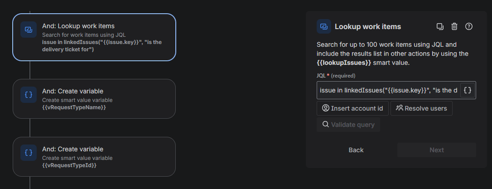

I was able to find the solution to this. I was going down a path more complicated than I needed. I was going down the path @Oleksii Melnyk _MOY Apps_ suggested. To go into a branch for linked issues, and set variables that I wanted to use outside of the branch -- a suggestion Rovo told me would work by the way -- but there was a problem: variables set inside the branch are empty/inaccessible outside the branch.
Because my head was going down that path, I failed to think about the much simpler "Lookup work items" action.
I ended up creating a lookup action with JQL: issue in linkedIssues("{{issue.key}}", "is the delivery ticket for")
Then I was able to set variables to values such as: {{lookupIssues.Request Type.requestType.name}} in subsequent steps.
I hate to be that guy that wasn't patient enough to find the answer before asking the question, but today I'm that guy. Maybe this will help someone else someday.

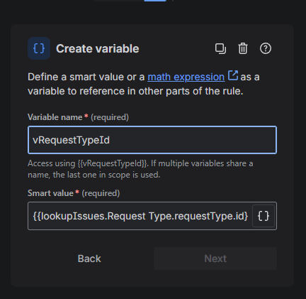

Bill Sheboy
February 17, 2026
One more thing for the rule images you just posted...
The Lookup Work Items action gathers zero-to-many work items, and the inline format of iteration you use to get the request type ID could possibly produce zero-to-many values, in a comma-separated values list.
There are two ways to manage this, depending upon whether or not you want to handle returns of more than one work item:
  • Add a smart values condition to confirm {{lookupIssues.size|0}} equals 1 before creating the variable
  • Or, only get the first item returned, ignoring any others: {{lookupIssues.first.Request Type.requestType.id}}
Like Susan Waldrip likes this
