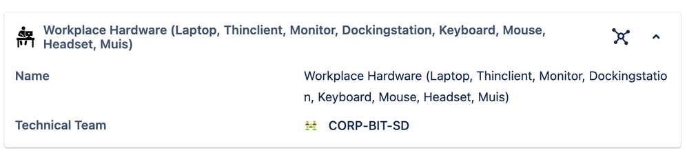

Hi @JEFFREY SCHNEIDER
Why would you like to fill the 3 read only fields with attribute data?
You can also adjust the assets configuration on the custom field.
In the option in the config, Object attributes to display on issue view
You could specify the other attributes, like date, city.
these details will be visible in the issue.
Example:

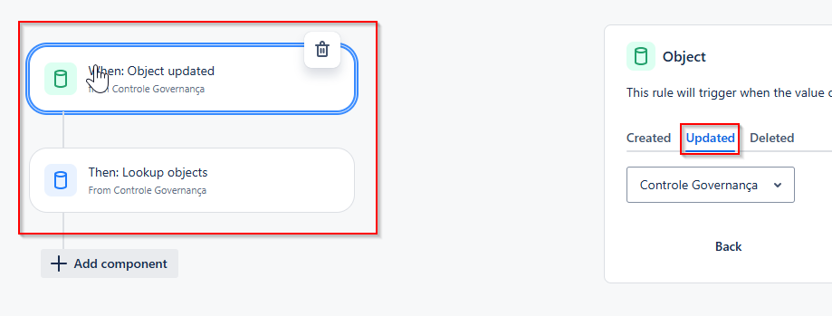

Hello @JEFFREY SCHNEIDER
you could try something like this
Trigger "Object Updated"

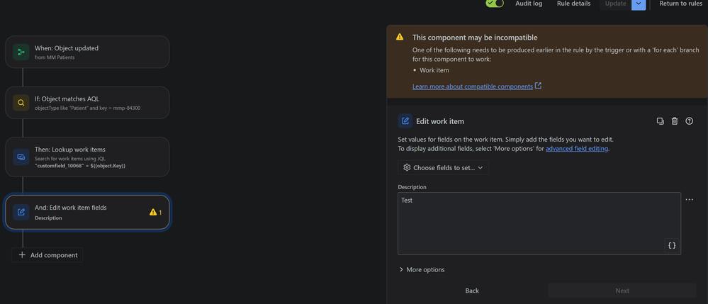

@Raphael Lopes - I'm coming back to this problem after attacking a few more manageable items. I was able to build out my automation as you noted, but it doesn't look like this is possible as described, would you be able to show an example of a working automation or possibly guide me to where my mistake is? Attached is a screenshot of my work so far.

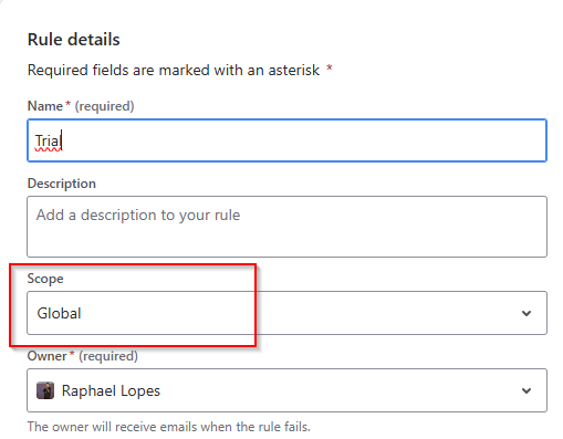

Raphael Lopes
May 1, 2025
How you doing?
Please, check that the scope of your automation is set to global.
Trudy P Claspill
May 1, 2025

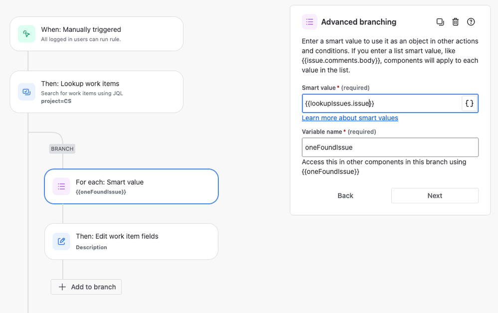

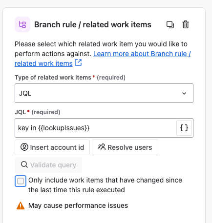

The problem you are encountering is that you have Looked up the work items you want to update, but that doesn't shift the "focus" of the rule to operating on those work items. When you execute the Edit Work Item action, the focus is still on the Asset Object that triggered the rule.
You need to use a Branch (For Each) after the Lookup  to shift the focus to the issues found.
There are two types of branches you could use:
Screenshot 2025-05-01 at 3.32.13 PM.pngScreenshot 2025-05-01 at 3.32.59 PM.png
