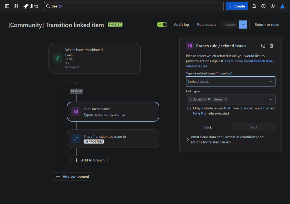

As for automation, it is probably fairly simple. Use something like:
That's assuming you have specific links between a ticket in the 'Main Board' and then one in 'Sub Board' (e.g. "clones" or "is cloned by").

The automation rule in itself does not have to be complicated:
  trigger: issue transitioned (from to do to in progress)
  condition: issue fields / project = your source project
  branch: linked issues (specify the type of link you defined between the issues)
  action: transition issue (apply the same transition)
Just wondering why you can't / don't simply let users track the original issue instead of duplicating it?
Hope this helps!
