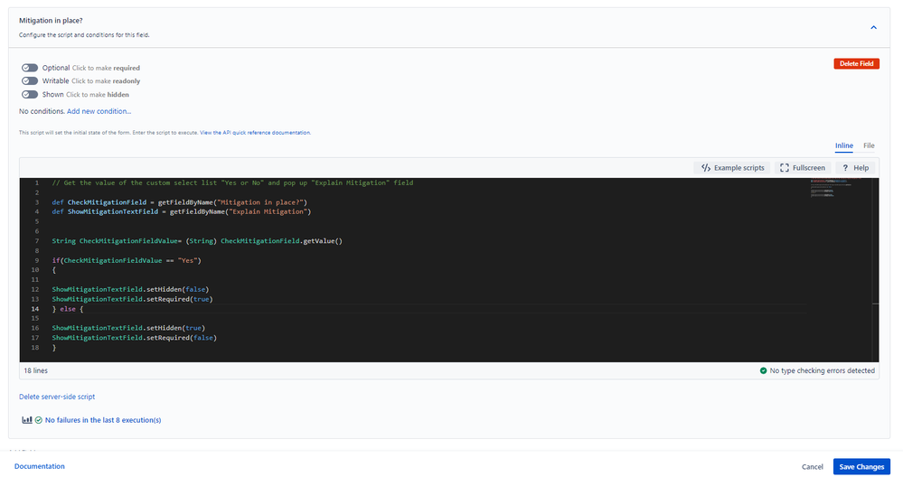

AnoopTripathi
October 14, 2024
Thank you Joe for your kind response. Yes I am using ScriptRunner’s behavior for control and the script is also associated with “Mitigation in Place” custom field still I can’t see the right behavior at Jira portal side. Please suggest what I may be missing.

@AnoopTripathi -
Try this after you defined the custom field variable  (You will need to get the value of the field for the comparison...
Example -
String CheckMitigationFieldValue= (String) CheckMitigationField.getValue()
Then use CheckMitigationFieldValue  variable in the if clause
f(CheckMitigationFieldValue == "Yes")
Hope this helps.
Best, Joseph

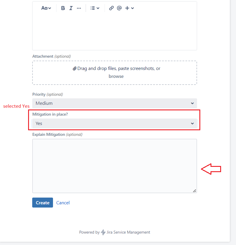

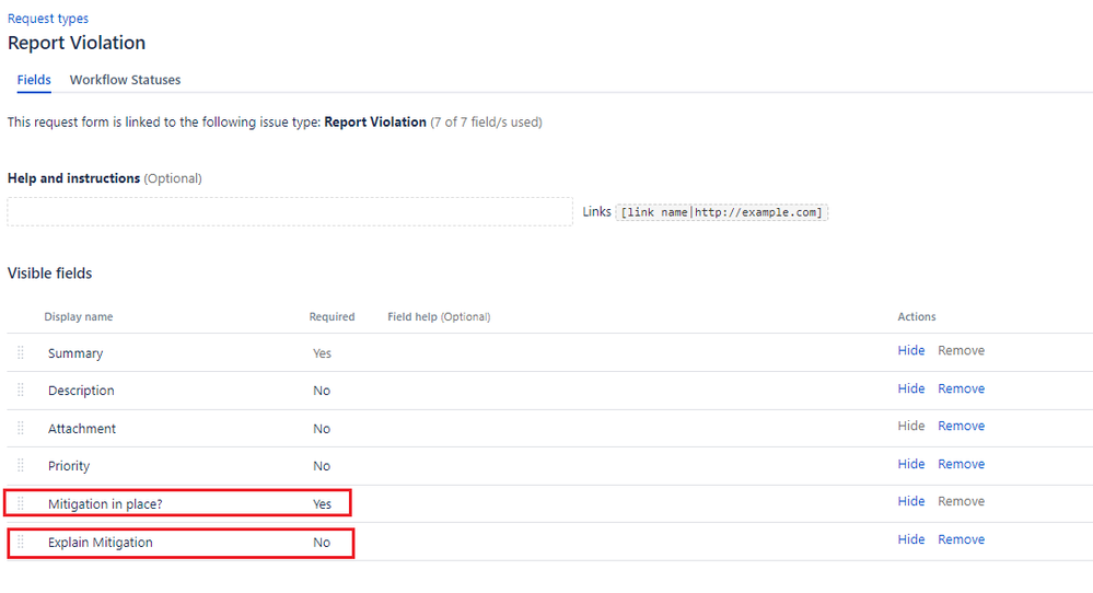

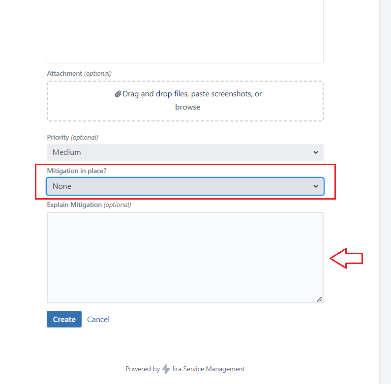

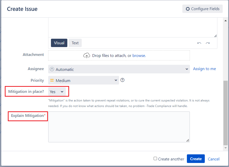

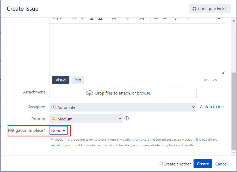

AnoopTripathi
October 14, 2024
Thank you Joe for checking and responding back. I implemented the change as per your suggestion but the issue is still same.
The create screen on Jira side is working fine but the service desk portal is not reflecting the as per the expectation. Please see the attached screenshot of the screens and behavior.
JiraSide-Working.pngJiraSide-Working2.pngScript-Behavior.pngServiceDesk Portal.pngServiceDesk Portal-Yes.png
