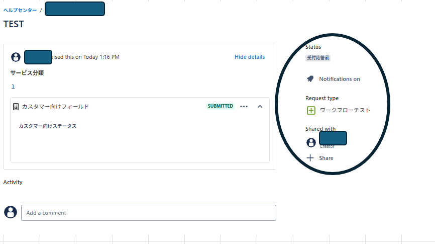

As a follow-up, I’d like to ask about the post-submission view on the customer portal.
After a customer submits a request, they are redirected to a screen where they can view the current status of their issue.
I’ve created a custom field called "Customer-facing Status", which I plan to update using automation rules based on internal status changes.
I’d like this field to be visible to the customer on that screen, but not editable — just a read-only display.
Specifically, I’m trying to edit the right-hand side section of the portal screen (the one circled in the attached image), where the status and other request details are shown.
Is there a way to configure the portal to show this custom field after submission, and not as part of the initial request form?
Marc -Devoteam-
October 24, 2025
Hi @田中優貴
This is not possible in a Team-managed project, this can only be done in a company-managed project.
To show simplified status names from portal only users, use the option on each request type, via Project settings → Request types → Workflow statuses, but only possible on a company-managed project.

Marc -Devoteam-
October 27, 2025
HI @田中優貴
Based on your follow-up question, this can only be achieved by 3rd party app from the marketplace, there is no ootb option for this.
