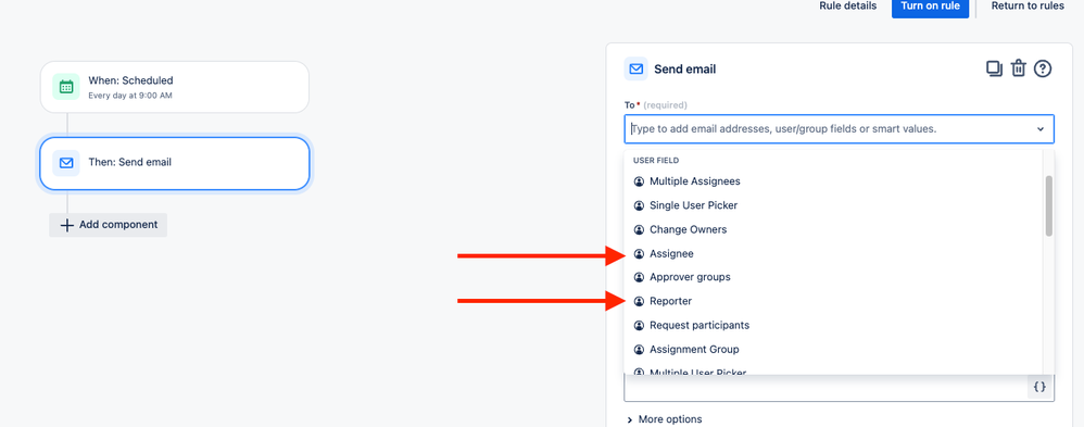

Here is a starter example of the trigger that would be used if you answered the above questions with "only exactly X days" and "only care about status changes".
You use the JQL statement in the trigger to find all the issues you want. In this case you want issues that are currently in a specific status and where that status has not been changed in the past 3 days.
You would want to make sure the checkbox below the JQL statement is unchecked.
You would follow this trigger with the action to Send Email. That action would execute for each issue found by the JQL in the trigger. The Send Email action will let you choose from the user picker fields in the issue to select the email recipients.

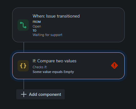

Jon Correa
April 5, 2024
@Trudy P Claspill @Joseph Chung Yin
Thanks for your response, unfortunately I don't have anything beyond:
Issue Transition from Open to Waiting for Support.
I can't figure out how to use smart values to basically create:
If: Issue Transition is on/over 5 Business Days
Then: Send email to Assignee and Customer (with custom text saying please check ticket or w/e)
I don't know if it's just me, but it's hard to find the correct syntax for doing this.
