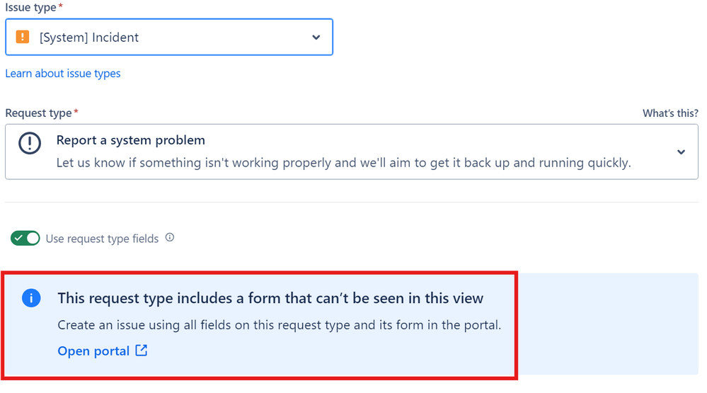

It worked but I have two questions.
1. You have to go to the customer portal to create the issue. Can you do this in the below user/agent issue creation page?
2. It is not a field but a form, is there a way to do this using fields?
Thank you!
Mikael Sandberg
May 20, 2024
No, forms cannot be visible from the Create issue screen, you would either enable the generic URL from where you can create issues, or after the issue is created you add the form to it.
If you need it to be visible from the Create issue screen you would need an app like scriptrunner or one of the other scripting apps available in the Marketplace in order to do this. Also note that in order for customers to use the Create button they have to have a Jira license.
