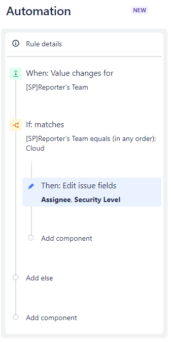

If you are just trying to assign the request to single user then use automation based on the field value change, for example below I have users reporters team. You can also set security level based on the same field. Similarly, you can choose any field & monitor it via similar automation. Just make necessary change in the automation & it should do the job for you.
Hope it helps.
