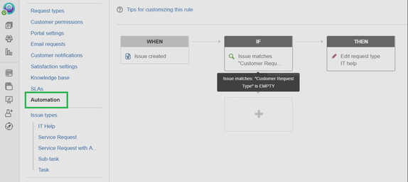

I believe you can achieve it by using an Automation rule to properly set the request type once the issue is created. These would be the steps:
1 - Create a new custom field or issue type so you can properly use to identify when the issues were created from the issue collector
2 - Navigate to the Project where the issue collector is configured > Project Settings > Automation > Add a new automation rule to set your request type when it is empty:
P.S: You can optionally add conditions to select different request types based on the issue type filed in the issue creation.
Let us know if you have any questions.

Actually, you can configure the automation mentioned to create the issue with any request types you want. You just need to use a field where the user can select from which Issue collector he is creating the issue. Once you do it, you can select the request type by adding a condition to the automation rule.
Please, let us know if you need further clarification about the steps above.
