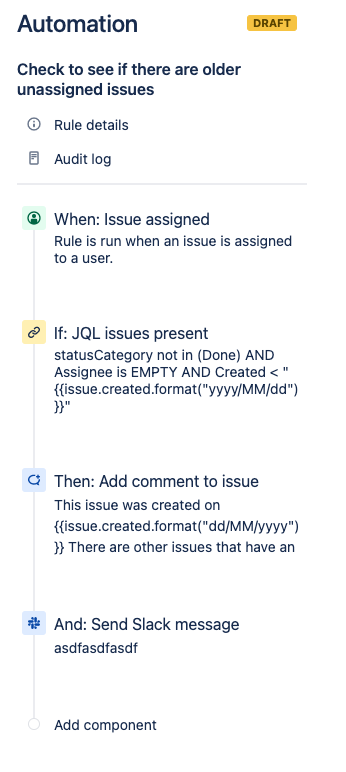

Hello @Xavier Margalef Riestra ,
Welcome to the community and I believe you can set this all up using Automation for jira.
First, you can send a notification to Slack using automation as described here:
The next portion is identifying what issues fit the criteria you are looking for.  I am thinking that you can use the "Issue Assigned"  trigger event, with a "Related Issues" Condition set to "JQL Issues" and a filter like the following using a smart value for a comparison of the current issues creation date to all other issues creation date, noting that as a project-specific automation rule it will automatically restrict the JQL to the project:
statusCategory not in (Done) AND Assignee is EMPTY AND Created < "{{issue.created.format("yyyy/MM/dd")}}"
Another note: the date format may be different in your instance based on your global settings, you can run a test search in the issue navigator first to verify what format the date needs to be in, and the following article gives some additional details on smart value date formating:
So something like this:
