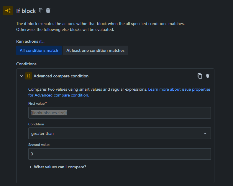

I assume you are using the Lookup issues task to fetch the issues?
You could use an if/ else condition where you check for any results returned by the lookup issues action: {{lookupIssues.size}} > 0
Like this:
Then you can configure the send mail actions depending on the outcome:
