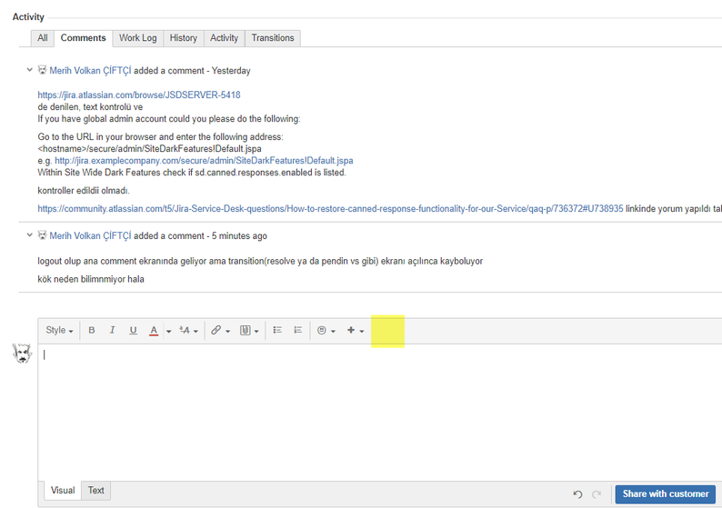

Hi;
We have lost  "Canned response" icon from Wiki toolbar  for all users. I've just updated  other plugins then icon is gone.
i have also checked permissions, dark areas( is listed) , restarted jira and googled but  cannot  get it back.

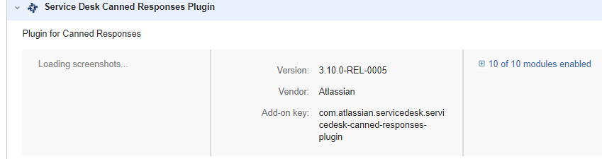

any ideas?
(using JSD 3.10.0 , Jira 7.7.0 , server)

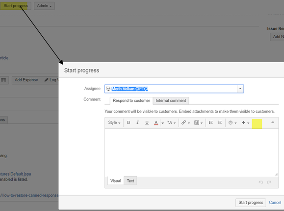

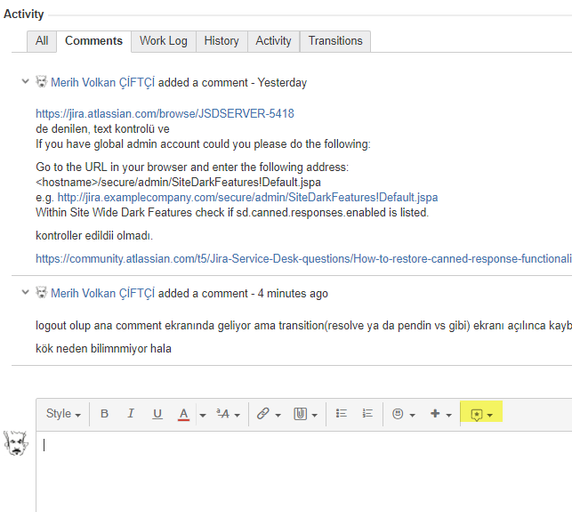

volkan ciftci
February 28, 2018
noticed that
logout and login again, it is  appeared
then select a transition (it is disappeared)
and disappeared everywhere
