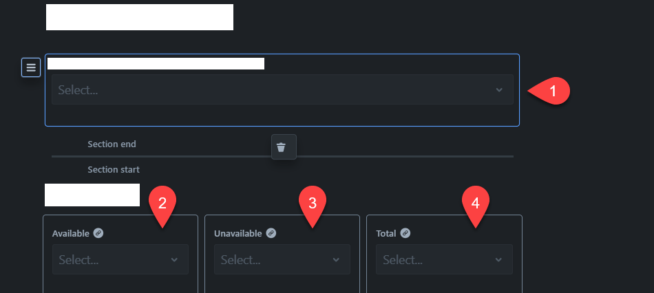

I am making a form which references an Object Schema of equipment with the attributes name, available, unavailable and total. I have 4 custom fields for accessing this data.
The first custom field populates the initial item selection dropdown list in the form. I would like the other 3 custom fields to automatically populate with the related attribute values for the selected object.
The first custom field works as intended, but I can't seem to reference the attributes of the selected object properly. I am most likely using the wrong AQL for this.

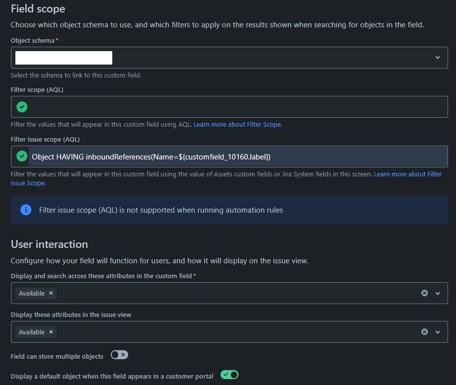

I've tried filtering the issue scope using Object HAVING inboundReferences(Name=${customfield_xxxx.label}) and selecting the attribute I would like to populate the form dropdown lists in the User interaction section of the Asset Objects field configuration for the custom field. This populates the second dropdown with the same list of objects in the first dropdown instead of the attribute.
Form
Example of an object in the Test Schema
Custom Field for number 2 (3 and 4 will be set up to search for their respective attributes.)

You should be able to have a custom field show an objects attributes automatically on a form, but for some reason it does not work properly and will not automatically display the data upon selecting the device. This was the only work around I found to make it automatically populate upon selections.
If you want the data to show up automatically in the current version of JSM cloud, you will need to make an object type for each attribute and reference the main object.
For instance, I had Devices as my main object and wanted the attributes available, unavailable and total. I created those attributes as objects of their own and added a device attribute to them as an outbound reference.
On the form there were custom fields created for the device and each attribute.
Example of the Available custom field:
Filter scope (AQL)
objectType = Available
Filter issue scope (AQL)
Devices = ${customfield_[customfield_ID}}
(This custom field ID was the selected device on my form. It is looking in the available object for items with that outbound reference)
Display and search across these attributes in the custom field*
Name
Display these attributes in the issue view
Name
(Set these to automatically show the Name attribute of the available object)
