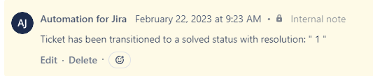

Hi, first question on this community forum.
I'm trying to add some automations to our Service Project. I want to record in a private comment when a ticket has been marked as resolved, what Resolution was chosen. So, the automation rule is similar to: When the issue is transitioned from In Progress to Solved, add a private comment saying:
"Ticket has been transitioned to a solved status with resolution: [[placeholder]]"
For the placeholder, I've used the tag {{issue.resolution}} - However, this prints a "1", not the actual resolution name.
What tag should I use instead, or how can I print the actual name of the resolution?
John Funk
February 22, 2023
Hi Lucrecia
{{issue.resolution.name}}
Lucrecia F.
February 22, 2023
Thanks for the quick answer!!
Do you know if there is a list somewhere with these more-detailed tags? I only found this list, which is unclear then, as {{issue.resolution}} does not "return the issue's resolution" as anyone would understand it...
