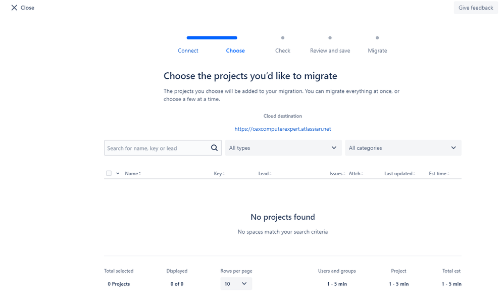

When creating a "new Migration", I'm not shown any projects for selection

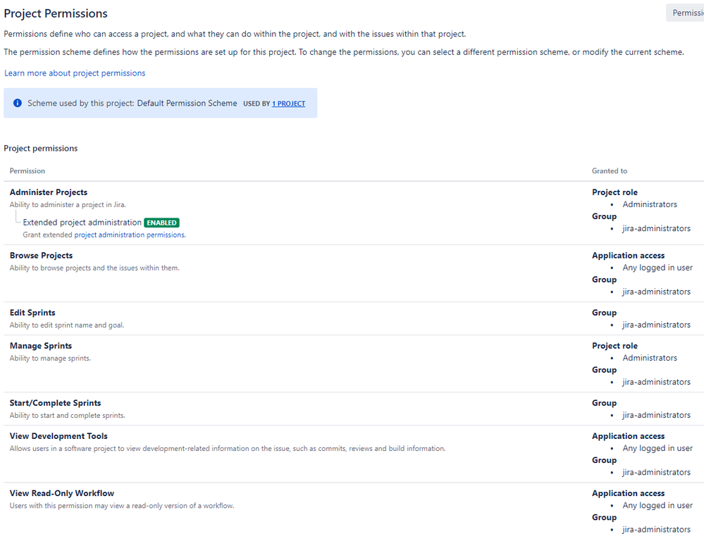

Actually, I'm using the "Default Permission Scheme".
In this Scheme, the group "jira-administrators" are allowed to do anything.cex.png

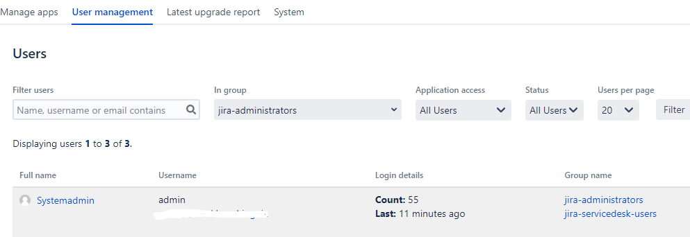

And as you can see, the systemadmin is a member of the jira-administrator group.
So why still can't see the project during migration?

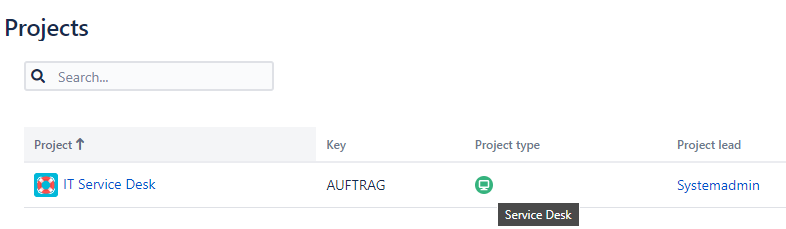

It looks like the project is a Service project, and JCMA currently does not migrate Service projects; that's why it's not listed.
