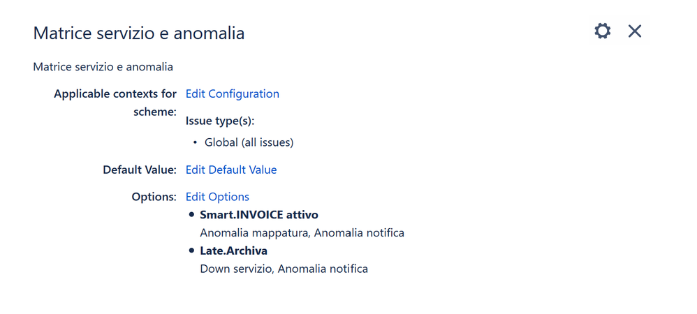

I have created a custom field in the ticket configuration (following other questions that have been raised):

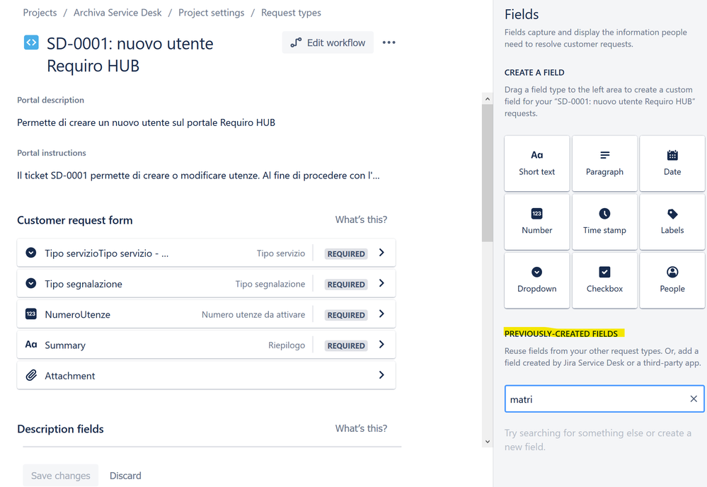

And I have associated it with any issue in any project but I am not able to select it in the issue configuration:
I am worried that I can use the custom field only in JIRA issues and not JIRA service desk ones. Do you have any idea how to manage the example above?

I can see that you created a custom field on Jira settings > Issues > Custom fields and on this page we can add the field on Classic projects. Your second screenshot is related to a next-gen project, which is independent of other ones.
With that said, custom fields created out of a next-gen project won't appear in Request types, you must create the fields directly in the project.
If you need this specific field, the best option is to use a Classic Service Desk project.
