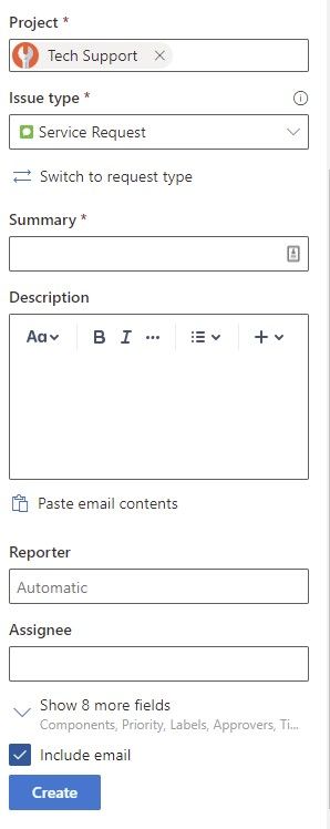

Let me rewind here a bit. Who created the issue in the project initially and how did they do that? From what I read initially it seems that the IT agent created the ticket for the customer. Then the question is did they use the create button at the top or did they use the raise a request link on the side bar? If they use the create button it doesn’t go through the form that the customer normally would via the portal as such what is often missed when setting up the request is actually setting the customer request type. Given that issues within all JSM projects deal with customer request type not issue type it is important that that it is correctly set. Otherwise if a customer goes to their portal and looks for the issues they raised the issue will not show up if the customer request type is not set. Note if a customer sends in an email to the JSM project then the customer request type is automatically set based on how the email channel is configured.
Tadd
July 14, 2021
I see.
How the ticket is usually created is the agent will use the outlook integration.
The Reporter is then set to whoever is reporting the issue. The Issue Type is set the same as when someone is emailing the tech support email.

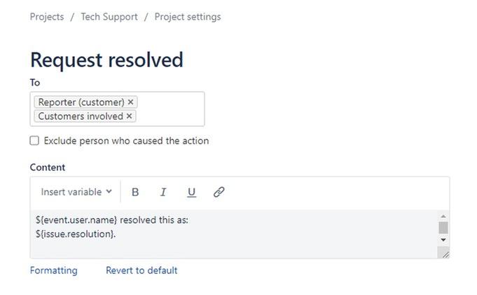

The other thing is, when something is resolved, the setting is to Reporter(customer) and Customers involved.
Screenshot_5.jpgWhich, in my mind, shouldn't matter what the Issue Type is.
I'll poke around the settings to see if I missed something.
