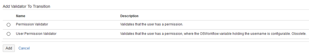

but I am not quite sure where to find this kind of validator. I do only have these two:
btw I am using server version of the service desk, if this makes the difference?

I think you are not using JSU add-on, this validator is available for Jira Suite Utility Add-on.
