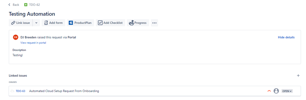

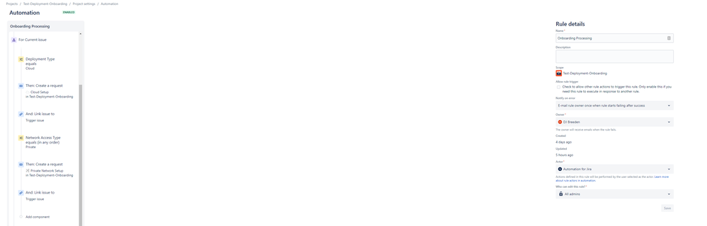

This is in the Create Service Request action (Service Desk), not Create An Issue (Software). I have indeed tried the link issue action within the automation, but in the Service Requests that get created, there is no established links setup on the requests after creation

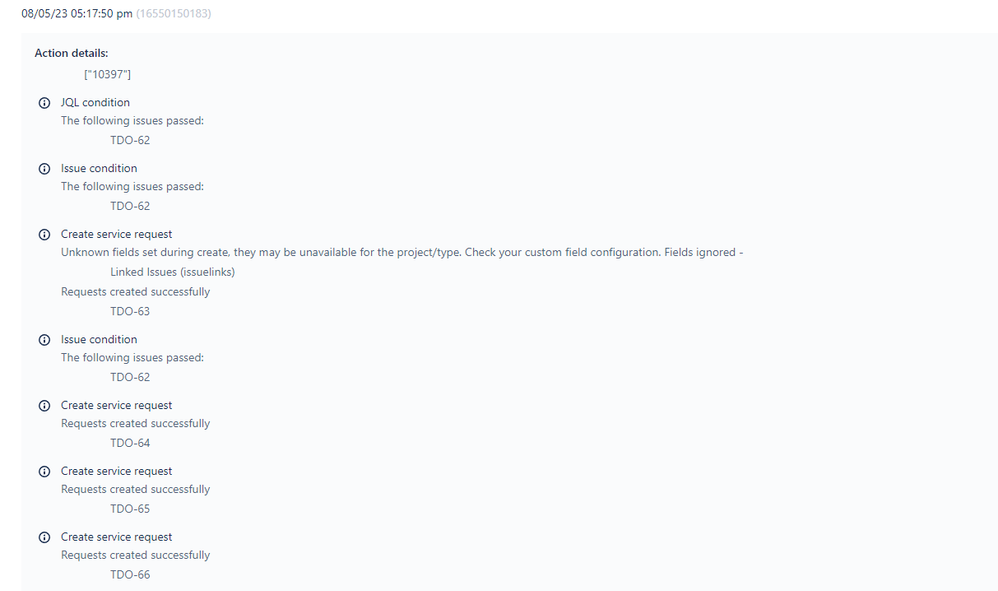

Below is an example of the audit log. It just shows the successful phases for the request creation, but not specifically anything about the linking

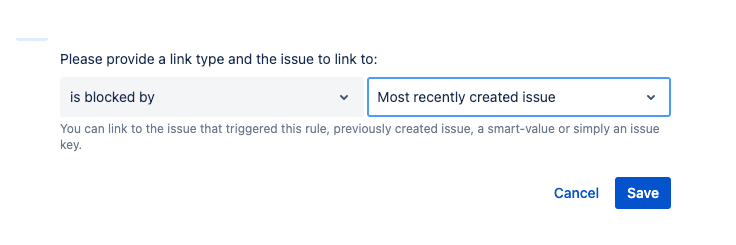

Your Link Issue action, based on its position, is in the context of the trigger issue, not the newly created issue. The net effect is it is trying to link the trigger issue to itself.
If you want to link the newly created issue to the trigger issue then:
1. Add a Re-fetch Issue step after creating the new issue.
2. Set your Link Issue action thus (selecting the appropriate link type):

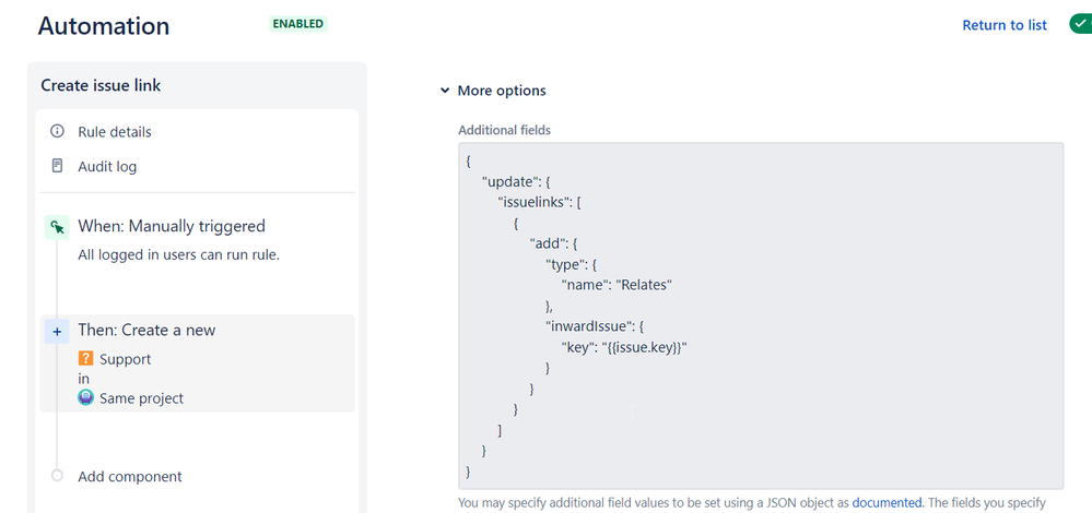

Hi, @darrellb - how are you trying to link your tickets in your automation? Via the Link Issues action? You may not be able to do it that way, but you should be able to via the More Options JSON field at the bottom of most actions.
It would look something like this:
"update": {
"issuelinks": [
"add": {
"type": {
"name": "Problem/Incident"
"inwardIssue": {
"key": "{{issue.key}}"
"add": {
"type": {
"inwardIssue": {
"key": "{{triggerIssue.key}}"

I tried that but received the error listed in the original statement:
"Unknown fields set during create, they may be unavailable for the project/type. Check your custom field configuration. Fields ignored -
Linked Issues (issuelinks)"
issueLinks doesn't appear to be part of a ServiceRequest object like it is a Jira issue

Same problem. Audit log fails that:
darrellb
May 8, 2023
Yeah the issue isn't the Type, it's that the issueLinks key doesn't seem to exist in the service request as pictured above
