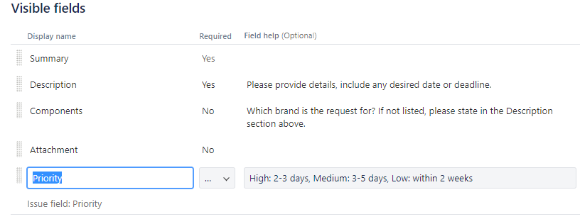

Hello,

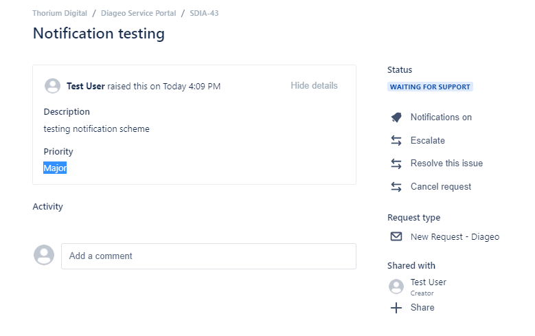

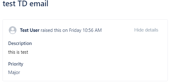

In my Customer Portal, I have listed Priority as a required field in the form. (See attached: Form Priority).  The priority level does not match up to issue created in JSM.
For example, the form's Medium becomes Major in the portal Detail view but Medium in Service Request.
Another example, the form's High becomes Critical in portal detail view but High in Service Request.
This becomes confusing to customer as they enter one state and the detail view shows them another.

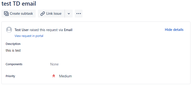

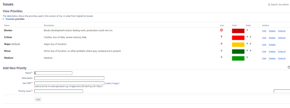

The second one shows a ticket that was created via email. When creating a request via email, only the summary and description can be required, all other fields must be optional.
With this said, when a ticket is created via email the priority will be the default one set on Cog icon > Issues > Priorities.

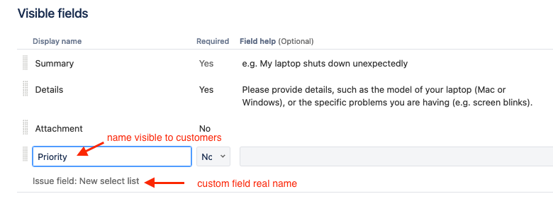

Another thing that it’s important to check if it’s indeed the field Priority that is visible for customers in the portal.
When adding a field in the request form, it’s possible to add a display name, so for example, you can create a field that internally is called “Customer priority”, but you can add a display name “Priority”. So, the “real priority” will be “medium” and the priority the customer selected will be “high” because they are actually not the same field.
Please, go to the Request type > Request form and check this information.

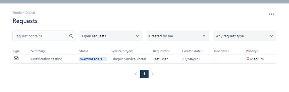

Here is another example where we the request is opened within the portal and not from email, same issue here.
Same ticket, in different view with different priority for Test User. (Medium vs Major)
Any ideas where I need to change to line them up?

Was there any translation added to the priorities (Cog icon > Issues > Priorities > Translate priorities)?

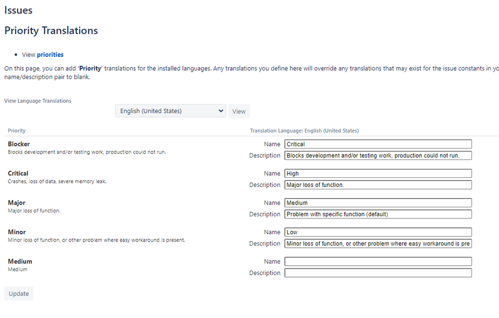

  • I found this translation but it seems to be the default settings. Is there a way to have different priority translation to just one project?

I asked about the translations because that’s the only option to add a different name to priorities. It’s possible to edit their original names, but it’s global, once it’s changed it will apply to all tickets and projects and the portal as well.
By default, priorities, statuses, resolutions are not translated and administrators can add custom ones.
What is happening, in this case, is that the translations are overwriting the correct name of the priorities for the customer on the portal.
Please, remove the translations and click on Update. After that, it should show the same priority for customers and agents.
