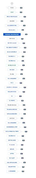

I have created a new classic project in Jira Cloud and need to know how to limit the status (or columns) available to just those in the board. these are the dropdowns that allow me to move the jira to another column. Say from "to do" to "in progress"  Currently, all statuses from all 5 boards are listed in alphabetical order, kind of a mess. Thanks in advance for the help

and here is the whole workflow:
These are all the status' in my project from all 5 boards. I want to limit the dropdown options to just the columns available on the board.  Thanks

To limit the status available to the ones you are using in a board, you will have to remove all the ones you do not want from the workflow.  i.e. make the board cover all of your workflow.
You can do that with simplified workflows, yes.
