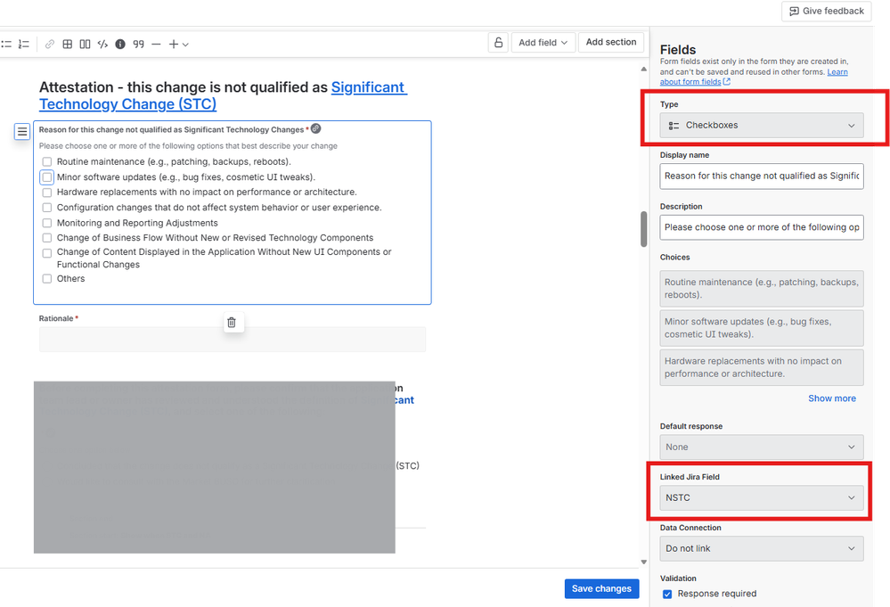

Hello team,
I want to analyze the answers of a particular JSM form question in PowerBI. To do so,  I have created a custom field in my project and linked the form field to it. Next I used PowerBI connector to get JIRA data for my PowerBI report. In PowerBI connector, I was able to find the custom field and I selected it along with other fields to my report. However, in power bi this particular field was not found while other fields were there.
Not sure if it's because the field type that it cannot be found in PowerBI. Could you please advise what happened and what should I do to get the answers in PBI for analysis?form field.png

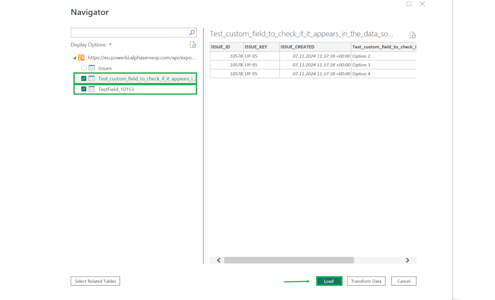

Hi Gemma,
Thanks for your question.
If you use the "Power BI Connector for Jira" application by Tempo Software, then the following solution may help.
Your checkbox custom field should form a separate table after the Power BI export. Thus, you need to export your data source and specifically pick the field (table) in question from the "Navigator" Power BI menu:multi_value_field_load.gif

Thanks Daniel,
That's exactly how we solved the problem. Thank you for your response here and I am sure it can help so many others.
