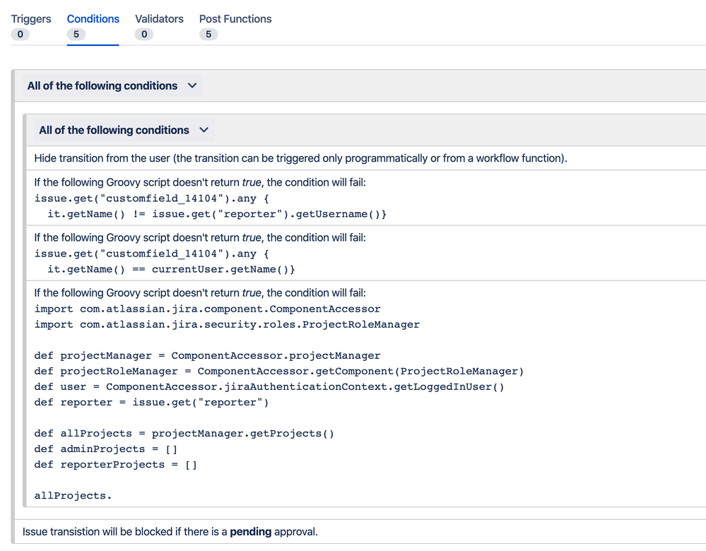

Does it means i only can set the condition for the approve button through plugin and not through as attached below?Screenshot 2020-02-11 at 12.20.14 PM.png

Thanks for the clarification, and that does change up the question a bit and I am not sure on this one.  I added a few more tags to try and get some additional visibility on this but I would also recomend reaching out to the Support Portal for Scriptrunner, to see if you can get some additional clarification on the functionality.
I am not sure if you can add scripted conditions to the workflow that would apply to the customer portal page, as the Portal is mapping values through Service Desk from the issue to the customer through the request type, and the workflow conditions are triggered from the internal view of the issue, and I am not sure if Scripted conditions will pass through in this way.
Scripted functions are location dependent and take info from the current issue view context and as the customer request portals mapped those values over I do not believe there will be data for the scripts to pull from this location on the desired actions applied to the conditions.
