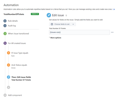

I need to build an automation which:
1. For a specific project (XXXProject), calculates the total number of tickets whose status is in "Done" and having issue type "Epic".
What I got so far:
Once the automation is run, the value obatained should be displayed in the dashboard under column "Total Number Of Tickets" which is a number field:
But, when i'm running my automation, I'm not getting any values in the dashboard.
Can anyone advise what's wrong with my automation?
Thanks.

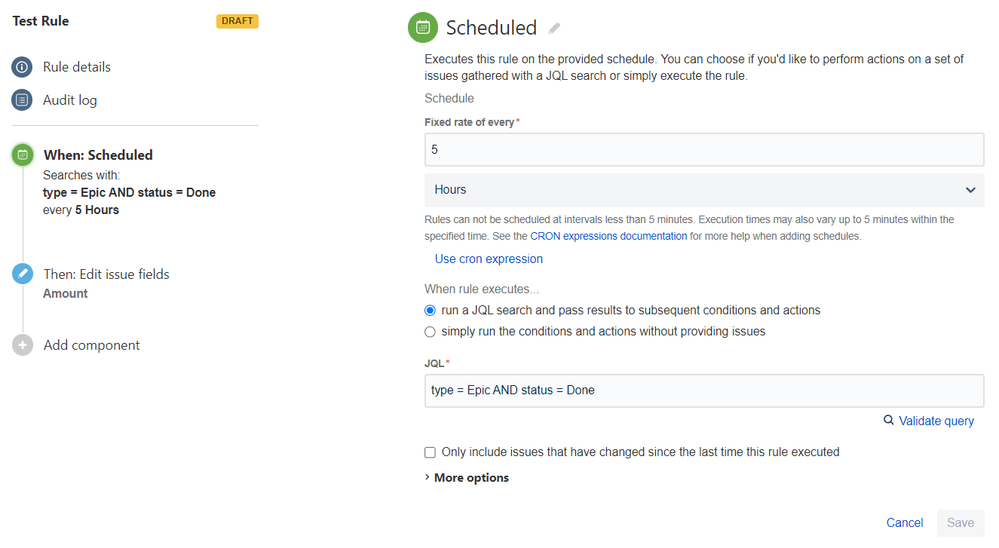

Hi @Krishtee,
{{issues.size}} can be used either with the trigger Incoming Webhook or the trigger Scheduled. Check out more info here in the documentation.
Here's the example of the rule:

Hi @Kseniia Trushnikova
Thanks.
I tried your solution.
It is displaying 1 for each tickets whose status is set to Done.
However, I need a calculation which will calculate the sum of all the tickets which have status Done.
For eg: If in a project I have 5 tickets and 3 out of it is in status Done, then the calcualtion should display 3 in the dashboard (column Total Number Of Tickets)

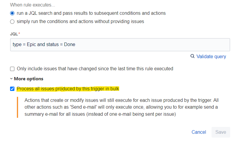

Kseniia Trushnikova
August 11, 2023
@Krishtee, my bad for not mentioning to select Process all issues produced by this trigger in bulk.
Try to run the rule once more with this option enabled:
Krishtee
August 11, 2023
Thanks for the help.
It works as expected.

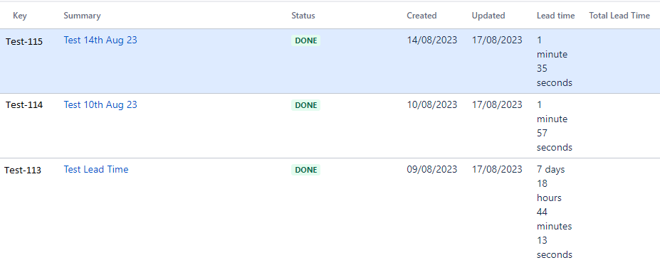

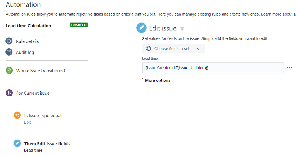

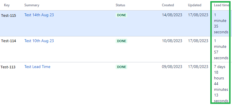

I have a custom field "Lead time", where i'm calculating the difference between field Created and Updated.
Please find below my automation:
This rule works correctly and is outputting the result in my dashboard:

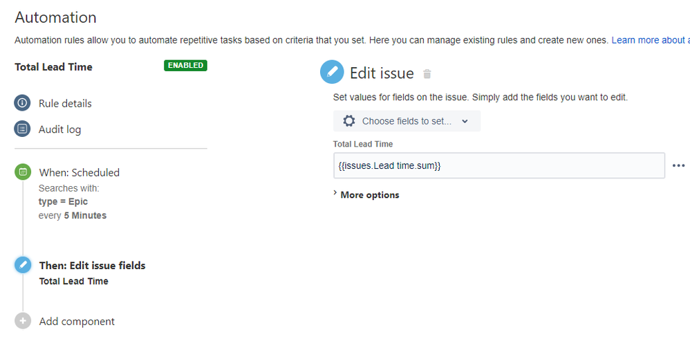

Next, I want to calculate the sum of all the values from field Lead time. For that, I have created another custom field "Total Lead Time".
For example: Total Lead Time = 1 minute 35 seconds + 1 minute 57 seconds + 7 days 18 hours 44 minutes 13 seconds
My automation is as follows:
But, when this rule is trigerred, I'm not getting any result in the dashboard (column Total Lead Time).
Can you please advise what is wrong?
Thanks.
Kseniia Trushnikova
August 17, 2023
Hi @Krishtee,
I'm not sure if it's even possible to sum up such values. {{issue.created.diff(issue.updated)}} returns a string, but only numbers can be summed up.
Anyway, I'd recommend you to create another question so other community users can advise you on it.

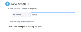

To calculate the number of tickets you have to run a jql query inside the rule with lookup issues action and then use smart value {{lookupIssues.size}}.
You can see the example on my screenshot below:
Hope this helps!
Krishtee
August 11, 2023
Hi @Alisa Zamaraeva
Thanks for helping.
Can you please advise how to proceed?
Kseniia Trushnikova
August 11, 2023
@Alisa Zamaraeva, it looks like @Krishtee's using Jira Server/Data Center. Lookup issues is available only for Jira Cloud.
Good answer though!
