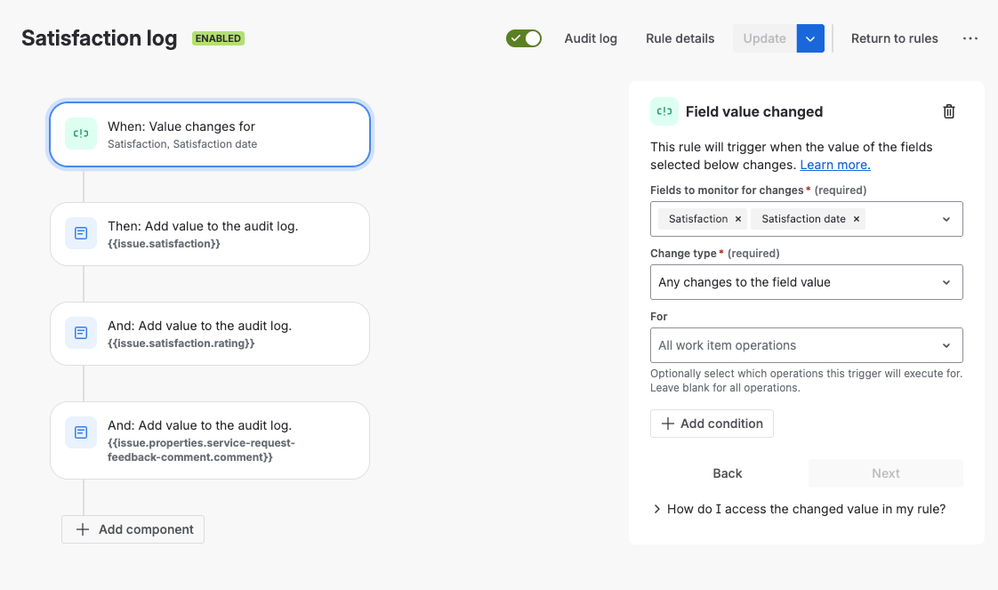

I found information for getting these values through Automation and constructed this rule.
While both Satisfaction and Satisfaction Date are fields that can be selected in this trigger. Satisfaction Comment is not. The native CSAT comment is not stored in a field in a JSM issue but rather in a property, which you can see that I am logging in the last step of my rule.

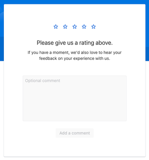

When the user receives the survey and clicks on it the screen they see looks like this

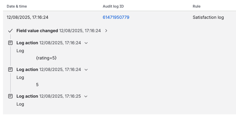

What I have observed is that when the user clicks the star in the survey the Rate and Date are immediately updated, but the screen remains displayed for comment entry.
And the rule is triggered immediately by the star-click.
