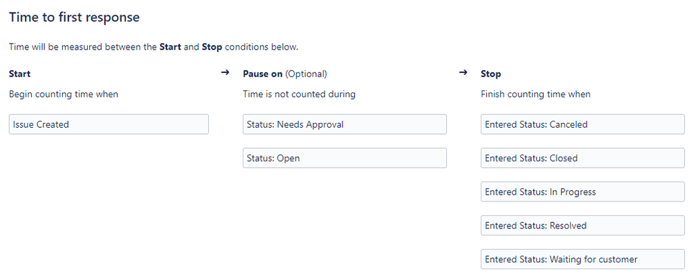

Philip Colmer
December 9, 2020
It turns out that there was another way to solve this ...
Screenshot 2020-12-09 154704.pngPause the SLA between the ticket being created and the ticket reaching one of the non-approval states. This has the advantage that it also works with the non-approval workflow which goes straight from creating the issue to "Waiting for Support" and thereby doesn't actually trigger the "enters state" rule.

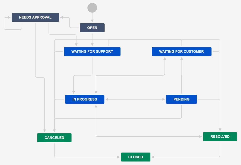

Philip Colmer
December 9, 2020
Here is the workflow we're using. The drawback to replacing "Waiting for Support" with "Issue created" is that I don't want the clock to start until the issue has been approved (if the reporter requires approval). That is why I set the SLA to trigger on "Waiting for Support".
Maybe what I need to do is change the workflow so that when the customer replies, it transitions to "In progress" rather than "Waiting for Support" ...

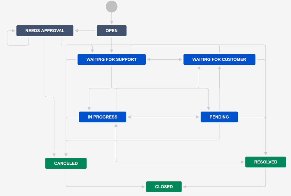

Philip Colmer
December 9, 2020
I've decided that, for my needs at least, the cleanest solution is to alter the transitions so that Waiting for Support can only transition to In Progress and then there are transitions between In Progress & Waiting for Customer.
This has a knock-on effect that the default "Transition on comment" automation needs tweaking.

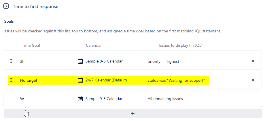

David Friedrich
December 9, 2020
Hi Philip,
you could define a no-target-goal to your SLA excluding every ticket that already has been in status "Waiting for Support" once before. Or - if that doesn't work -, make the query about all the statuses, that would imply a first response to the customer. The JQL for those two options would be something like that:
1) status was "Waiting for Support"
2) status was in (Cancelled, Closed, "In Progress", Pending, Resolved, "Waiting for Customer")
A third option would be a no-target-goal for tickets that already have one public comment. If that is possible with JQL i leave for others to answer ;-).
