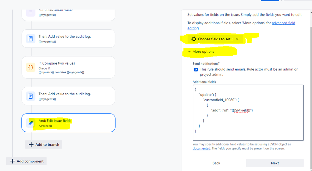

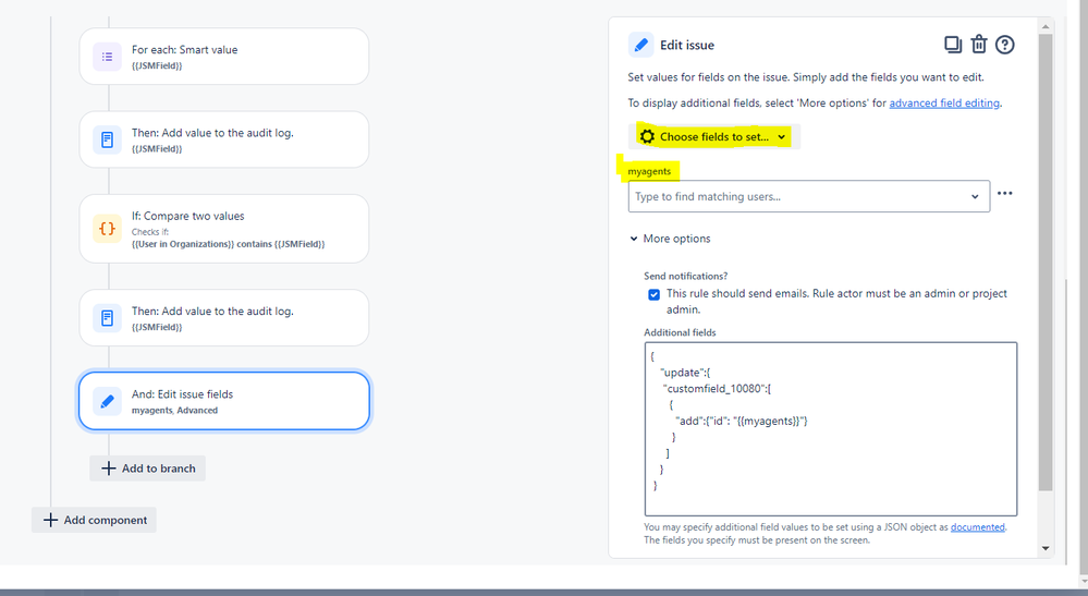

Hello @Jakeer
I just tested and it worked for me so I am not sure whats wrong with your set up.
Only thing I notice is that in your edit issue section, you are unncessarily choosing a field..
Nothing should be selected in the "Choose fields to set".. Only the advanced section should be set.
It should be like below screenshot..  notice I have no fields selected.. you have choosen "JSMField" in that dropdown.. we dont need to do that..

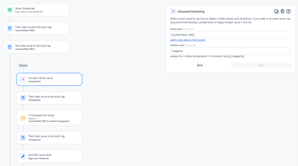

Steps:
  • After your trigger,
  • you do advanced branch, choose one of the fields to iterate, give it a name,(for ex "myagents")
  • then in next step, if condition -> advance compare -> smart value, check if the value is present in other field, (see screenshot, notice what we are checking against and implement the same way)
  • if so, add it to other (customfield_1003)field using advanced edit using below JSON:
"update": {
customfield_1003" : [
"add": {
"id":"{{myagent}}"
I havent tested this because I dont have this many fields, please see screenshot, implement and share your rule and audit log section to review.
Your Edit issue should use advanced Edit like below:

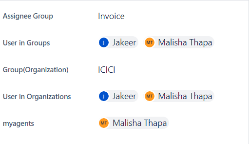

April 8, 2024
Jakeer
April 8, 2024

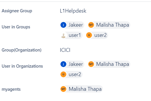

I have shared the screenshot where i am not part of Organization still my name sowing after changing the values.
Also If Jakeer and Malisha both are part of both the fields then both the names are not getting copied in the customfields-3

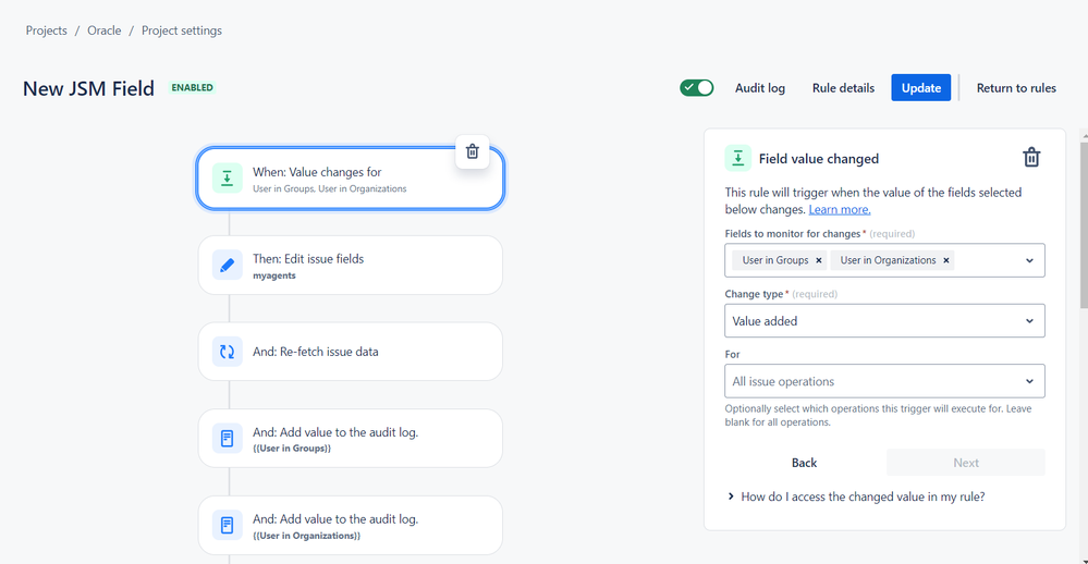

Hello @Kalyan Sattaluri
Sorry for the late response.
Please find the attached screenshots of the automation rule.04122024-1.png04122024.png04122024-2.png04122024-4.png04122024-3.png

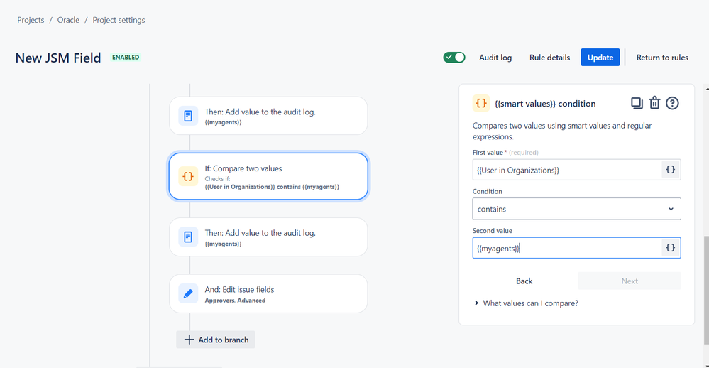

Hi @Kalyan Sattaluri
I am using the above automation rule to separate the agents who belongs to User in Groups as well as User in Organizations.
If in User in Groups = A, B, C, D,E
If in User in Organization = A,C,E
Then in myagents = A,C,E
But the above rule is not working as expected, it is randomly taking values although if they are not part of User in Groups as well as User in Organizations.
Can you plz look into it.

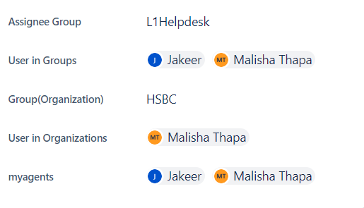

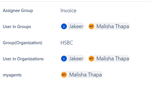

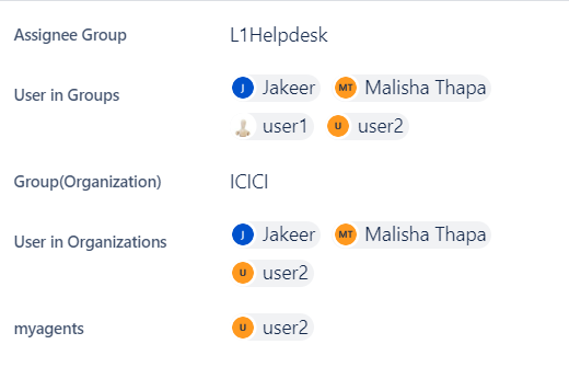

Jakeer
April 12, 2024
Here in User in Groups and User in Organizations you can see that Jakeer and Malisha are part but in my agents you can see only one name got copied.
Thanks,

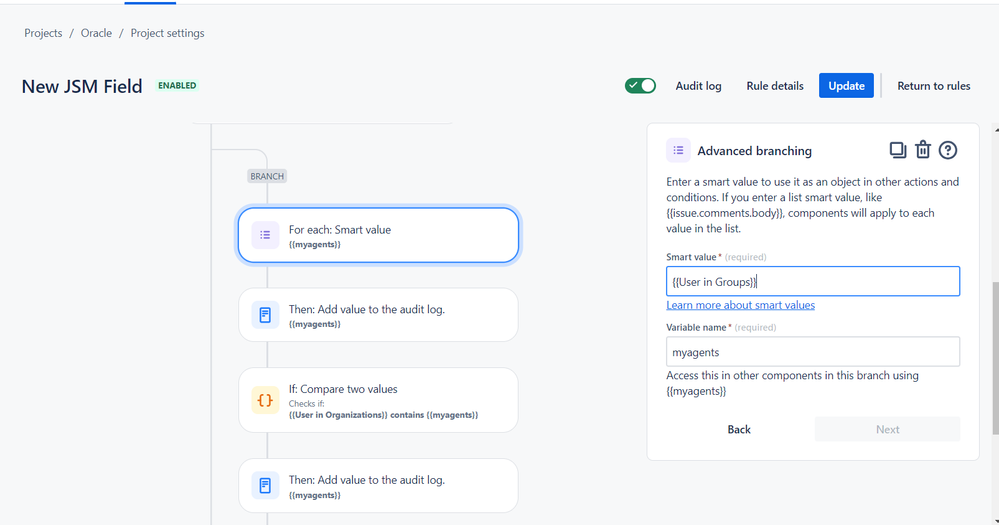

Kalyan Sattaluri
April 12, 2024

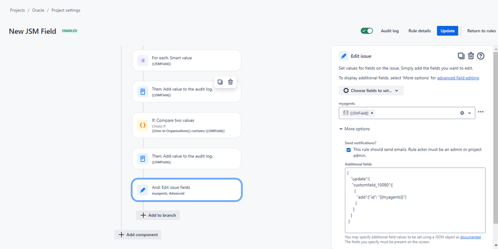

Hello @Jakeer
Is customfield_10080 called myagents? Can you rename that field to something else?
Also, in the last step, you can remove updating the "Approvers" field, unless you want that.
If you cannot rename customfield_10080 to something else, you need to rename the variable from myagents to something else and update your if condition and also the last step where in advanced edit you are referencing {{myagents}}. replace every where in the rule where the variable is being referenced with the new variable name..
So do either of the steps, retrigger the rule and share the log once again,

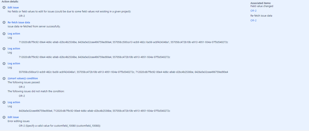

Jakeer
April 12, 2024
I have made the changes mentioned and in the result i am getting error.04122024-error.png
Please find the attached logs screenshot.
Thanks,

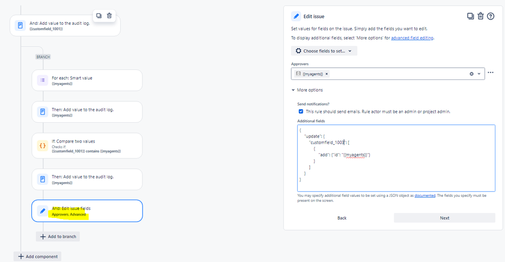

Kalyan Sattaluri
April 12, 2024
What is the customfield_10080 field called?
Is it approvers?
Also what change have you made? Did you change the variable name? If so, share with me the screenshot of where variable is being defined in advanced branch and also edit issue screen.
Jakeer
April 12, 2024
customfield_10080 is the field name myagents.
Please find the attached screenshot.
Thanks,
Jakeer
April 12, 2024

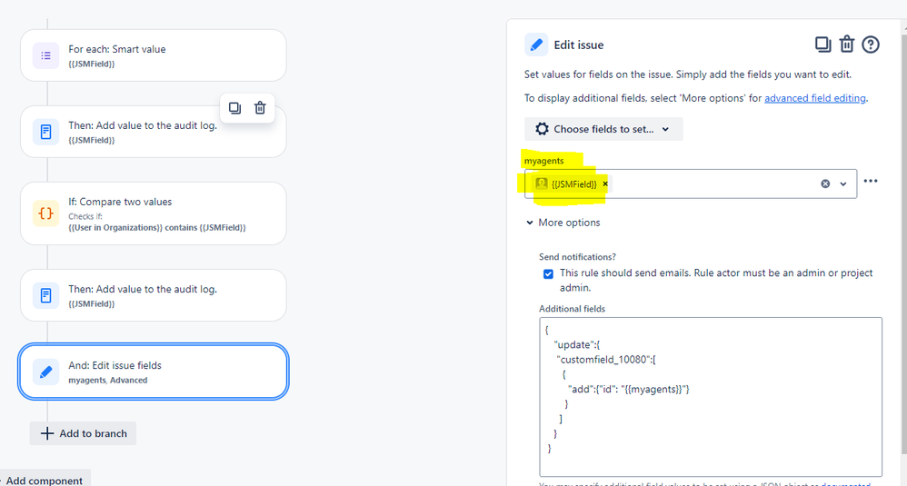

Kalyan Sattaluri
April 12, 2024
Remove the highlighted section below from edit/issue in your rule and retrigger and let me know what you observe
Jakeer
April 12, 2024
I have tried the same way mentioned still getting error.

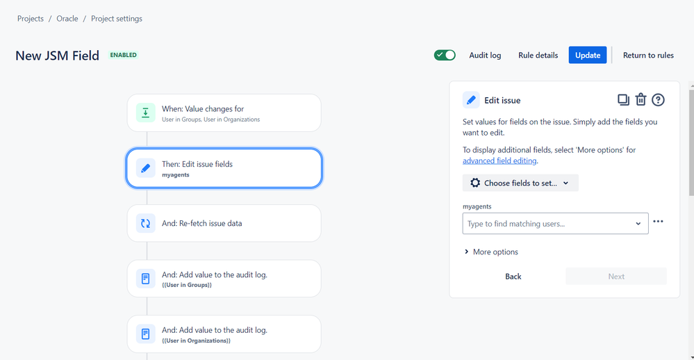

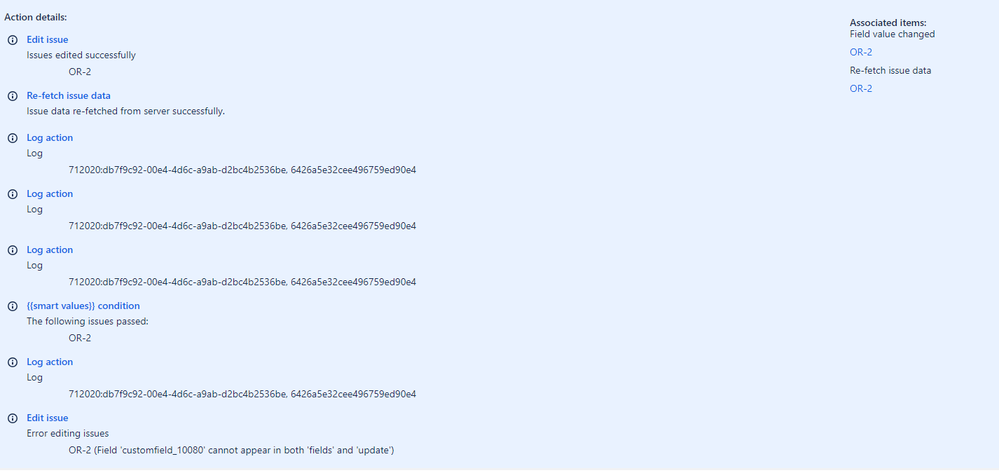

Jakeer, First share with me the Edit issue screenshot again. That error means we are trying to update the same field in multiple places. And we need to remmove references to that field. So share screenshot to resolve that issue firts.
Jakeer
April 16, 2024
Please find the attached screenshot of my edit issue.
Thanks,

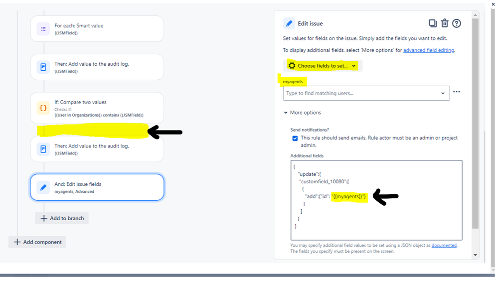

Kalyan Sattaluri

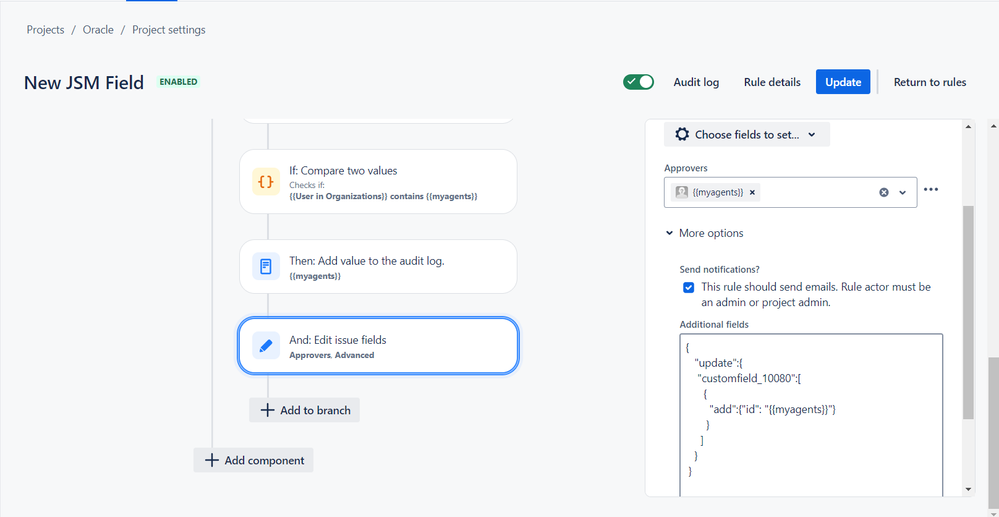

April 16, 2024
Hello, in the drop down "Choose fields to set", unselect the field "myagents"..
It should just be the advanced section...
see below screenshot and rerun the rule and share audit log.

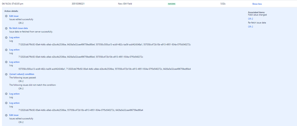

Jakeer

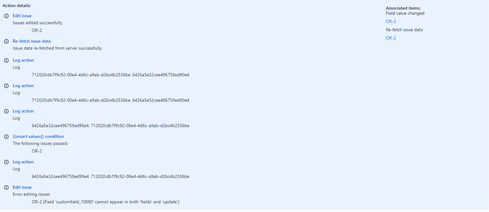

April 16, 2024
After making the changes the automation showing errors and the audit log screenshot is shared below.
Thanks,

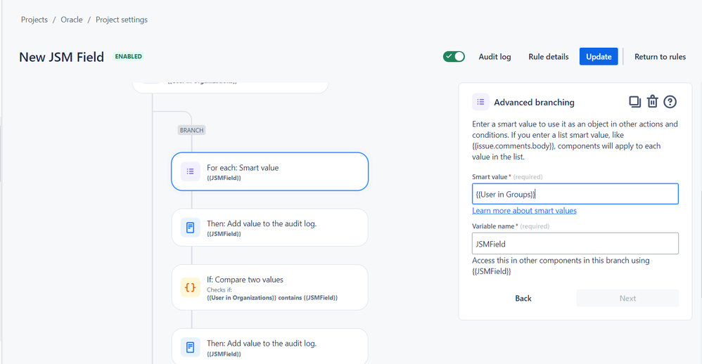

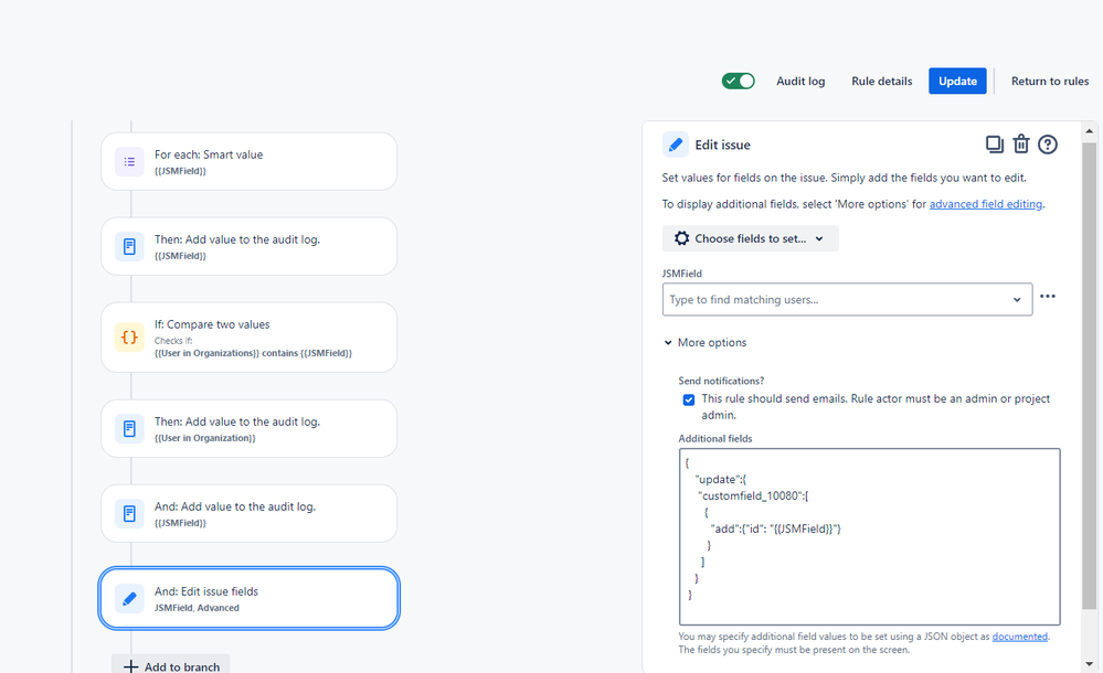

Kalyan Sattaluri
April 16, 2024

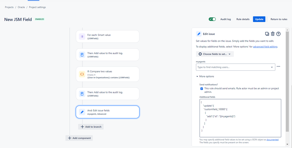

Jakeer,
I want you to do 2 things:
1) In the advanced edit, you need to change {{myagents}} to {{JSMField}} .. right now you are trying to edit field with itself. See screenshot where I am referring to.
2) Insert a new log statement above where you are logging {{JSMField}} and log {{User in Organizations}} .
Do both, rerun the rule and share audit log.

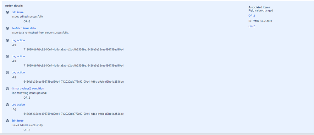

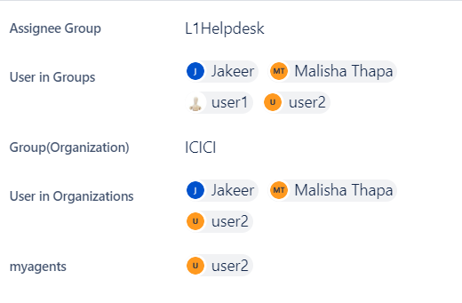

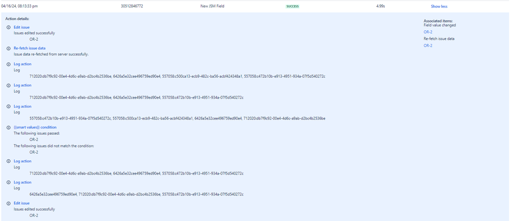

Jakeer
April 16, 2024
I made the changes mentioned above, in result automation is showing success.
But the values are not getting copied exactly.
If in User in Groups= A, B,C,D
If in User in Organizations = A,C,D
Common values are A,C,D But only A, D are getting copied if i refresh then A, C are getting copied then after i remove all values and refresh then all the values are getting copied.
Thanks,
Jakeer
April 16, 2024

Kalyan Sattaluri
April 16, 2024

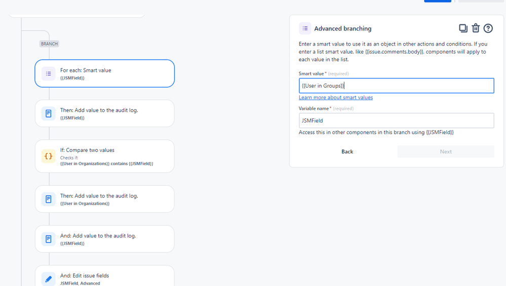

Can you select the "For Each smart value" and share the screenshot. I need to see both the steps and For Each details section together like in below screenshot..
I *think* I know the issue and we may have to store these values teemporarily before we update.. but yes, please select For Each and share with me the screen shot..
Jakeer
April 16, 2024
Hi,
Please find the screenshot.
Thanks,

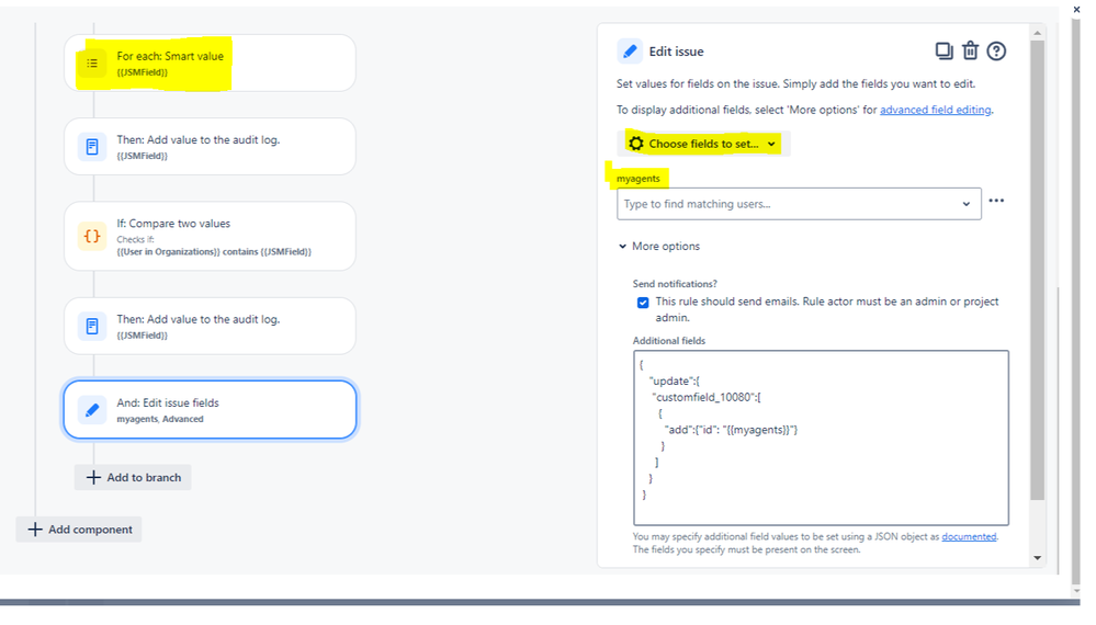

Kalyan Sattaluri
April 16, 2024
Hello Jakeer,
I need the For Each section's details.. not the edit issue. lol
Also, the earlier log statement should be {{User in Organizations}} and not {{User in Organization}}.. please correct this..
Please share with me the screen shot of "For Each" and a newly run audit log so i can compare..

Kalyan Sattaluri
April 16, 2024
Hello @Jakeer
I just tested and it worked for me. Only think I notice is that in your edit issue, you are again choosing a field in the "Choose fields to set" drop down... There should be no selection... We are using advanced section to edit the issue. Your edit issue screen should be like my below screenshot..

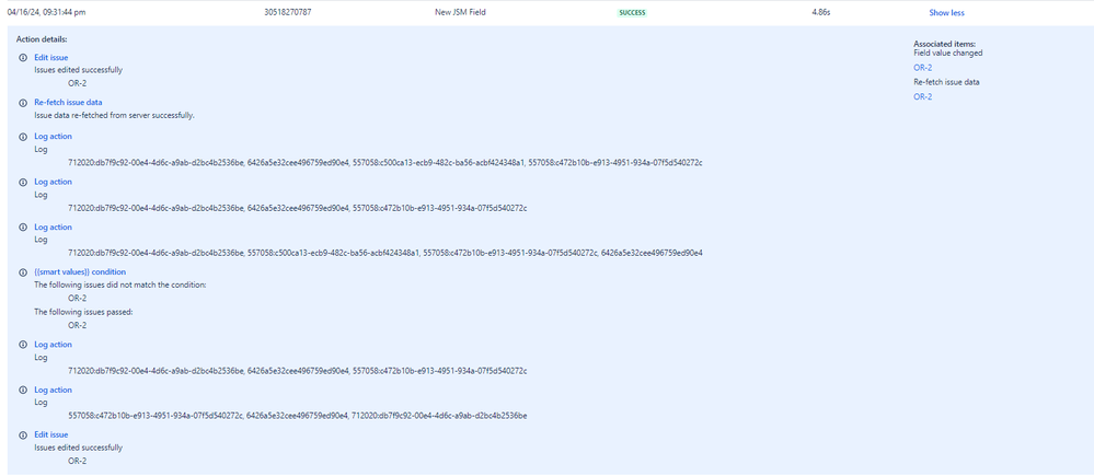

Jakeer
April 16, 2024
I made the changes and tested in the result i am getting-
Thanks,
Jakeer
April 16, 2024
Hi,
In the above screenshots you can see that the all common values in the teo groups are not getting copied.
Thanks,
Kalyan Sattaluri
April 16, 2024
Hello @Jakeer
Hope you are doing well. Looks like we have run into a bug in Jira here.
Looks like when we are trying to "add" within a For /Each logic, its not completing all the steps.
I am also able to reproduce the issue but I dont have a solution yet.
Let me think some more and I will update you if I find a work around. Apologies for all the back and forth with no solution.
