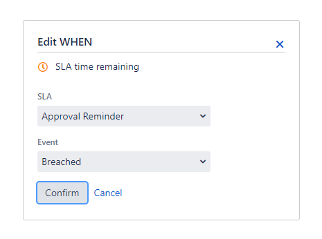

Hi @Hyunmi Christina Bae ,
You are on the right track and it's is how we usually solve these too.
  1. Create a new SLA (you can call it Approval Reminder or something like that)
  2. Set the goal on when you want to send the mail
  3. Have the SLA start counting when you go in to the status that requires approval
  4. Have the SLA stop counting when it leaves that status
For the automation rule, that would work fine with the Server automation too, you can create a rule that says
if "Approval Reminder" SLA is breached, send the email.
the email won't be the nicest one ever but it will get the job done.

Dirk Ronsmans
January 13, 2021

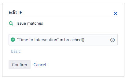

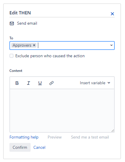

Ok let me split this up in a 2nd reply. Just to make sure my logic works I worked out how you can do this without an addon :)
You will still need the SLA to count when to send the reminder but your automation rule will be a bit different to allow a mail to be sent to the approvers:
1. Your Trigger would be "Approval Required"
2. Your IF condition could be "issue matches , "Approval Reminder = Breached()" (you can substitute your own SLA name of course)
3. Send the mail and since it's a customer notification now, you can send it to the "Approvers" field
Hope this helps! and apologies for jumping back and forth on this.
