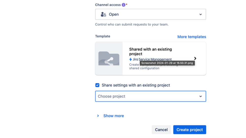

Lakshmi Kumari
February 12, 2024
Hi Sharu,
Initialy when the requirement was different, I checked the box with the option, "share settings with the exisiting project" so customers are able to see the portal login page of other customers too which is now causing confusion. Now I have been told to create separate login page for each customers..
So creating a separate JSM project is the only option now ?

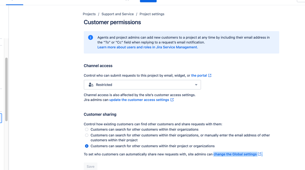

Lakshmi Kumari
February 13, 2024
Hi Sharu,
I wanted to turn off the option of "Allowing customers to see each other" in the customer permission section but I dont have such option. I have attached snapshot for your reference. I see "customer sharing" options which i dont need at all.
