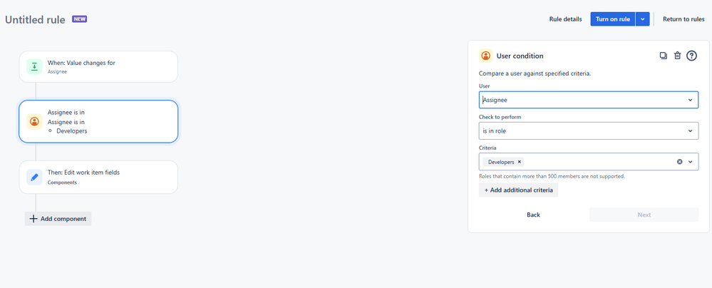

Hi Kelly,
You can check to see if the Assignee is in a particular role and then update the component based on that.
