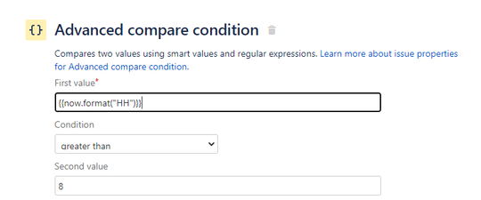

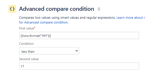

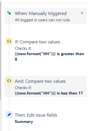

I played arround a bit with the timefunctions in Automation and came up with the following: (is this perfect or the only way, no. But will this work, normally yes :))
I created an automation with:
Trigger: Issue Created
Condition: Advanced compare {{now.format("HH")}} greater than 8
(this returns the absolute hour in 24h format) meaning that 8.59 will still be false but 9.00 is true)
and
Condition: Advanced compare {{now.format("HH")}} less than 17 (thats 5PM) so 4.59 is ok, 5pm not
Action: set a field.
I ran this as a manual trigger as a test and it works fine. I did use the 24h format as it's easier to distinguish between 5am and 5pm (5 vs 17) instead of having to find whether it's am or pm (and i use 24h clocks all day so :))
Hope this helps!
of course change this to issue created as a trigger and set the field you want to set in the end.

Greg Hart
September 15, 2020
@Dirk Ronsmans This is perfect! Trying to sell The Powers That Be on spending more money on yet another add on was going to be a chore. We've been using this version of automation for a while now, so this works out how I need it to. Thank you!

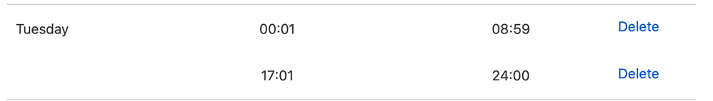

Hi @Greg Hart
You can enter a separate calendar for out of business hours like this:
Screen Shot 2020-09-14 at 09.33.32.pngThen you need to define separate goals with this new out-of-business-hours calendar with your JQL conditions.
The above screenshot is for sample 9-5 calendar, as you can see I had to split the calendar into two parts. You can adjust the calendar based on your working hours calendar.
You also need to create a boolean cf to separate tickets that created out-of-business hours. Thanks @Dirk Ronsmans :)
Let me know if you have further questions.
