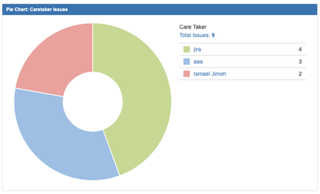

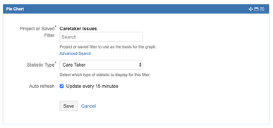

Doing the above steps would get you statistics of how many tickets each of the users in your custom field have been associated with for example see image below:
Gadget result
Gadget configuration.
