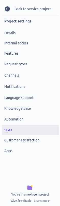

For Issue Type, I'm still can not find it in my Project Settings. i attached the screenshot.Screenshot from 2020-12-29 10-46-11.png
Daniel Ebers
December 28, 2020
In a next gen project have a look into "Request types".
URL shows still "issue types" - for this type of projects the logic is combined with the request types.
Here is the full explanation:
https://support.atlassian.com/jira-service-management-cloud/docs/issue-and-request-types-in-classic-and-next-gen-projects/

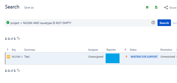

I see then, to create the SLAs, I could use issuetype field in JQL to refer the "request type?
Daniel Ebers
December 28, 2020
Daniel Ebers
December 28, 2020
yes, works using "issuetype" - just tested:
