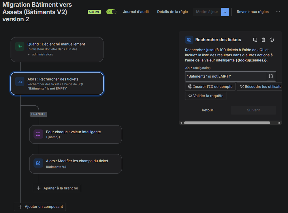

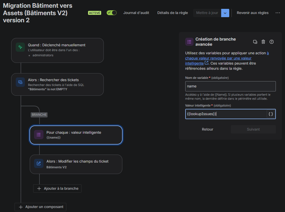

Thanks for the reply, i made a new rule and here are the screenshot :

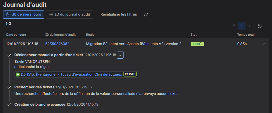

rule 4.pngUnfortunately, it doesn't work, i try on a issue DI-1513
So the data in "Bâtiment" are not copy ine the new field "Bâtiments V2"
Thanks in advance for help

Hi @Kevin Vancrutsen
For that issue, what is the current value of the field Batiment?

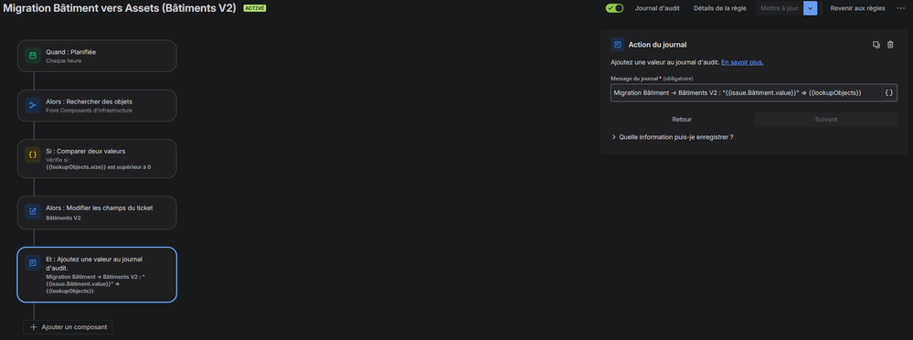

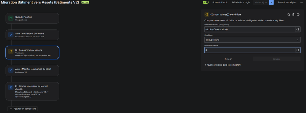

In the branch create a variable.
name: batiment, smart value issue.batiment.name}}
Then add a lookupobjects action to find objecttpe = batiment and name = {{name of created variable}}
Then do an edit action where field Batiment V2 is set with smart value {{lookupObjects.key}}
Please adjust the naming to the correct ones on your instance.
