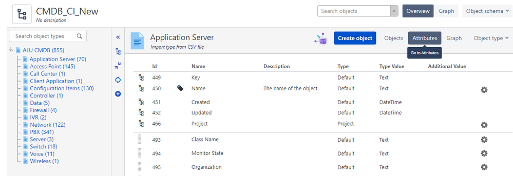

I have added asset objects with Object Schema as "CMDB_CI_New".
Added Object type as "ALU CMDB" and through CSV import loaded CI data into "ALU CMDB".
It has an attribute "Project" which should dynamically appear in the custom field "Configuration Items" in the issue form.
Under specific project (ALU) I need to show CI's only related to that project.

could you please post a screenshot of your object type structure and the attributes of the objects?
Hi @Shobana Regupathy ,
sorry that it took so long to respond. Could you solve your problem?
The screenshots look like on prem, but you selected Cloud with Standard Plan as deployment for your question. I guess this might be wrong, because Assests are only included in Premium onwards.
If it is on prem. You should be able to filter the objects via the issue filter scope. You could try:
Project = currentProject()This should work, if your Project attribut is actually of type project.
