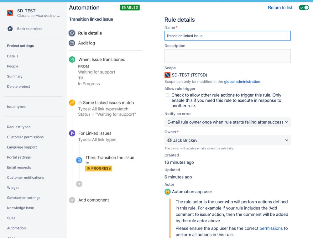

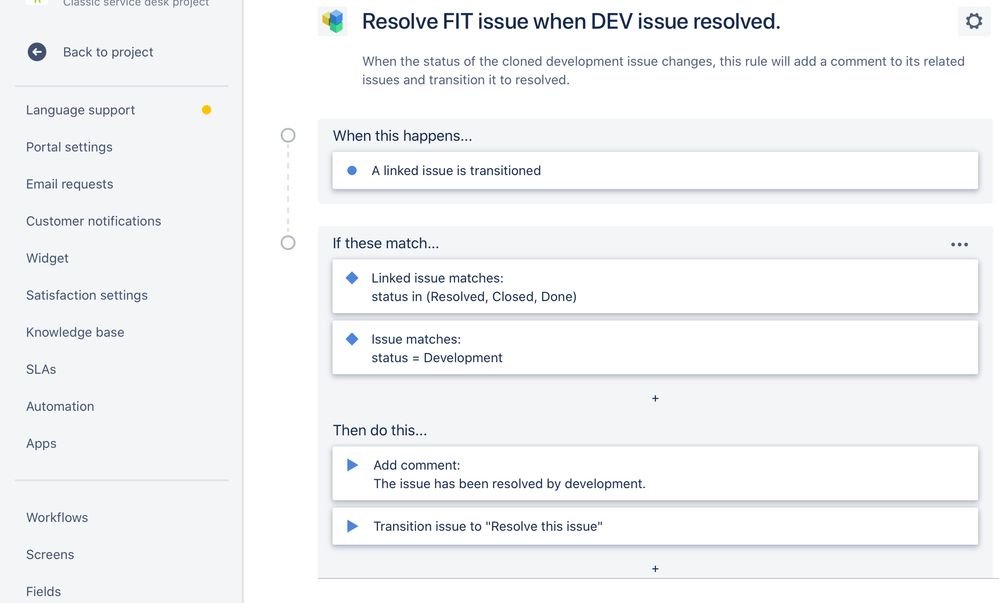

Which automation are you working with? I’m JSD there is “Automation” and there is “Project Automation”. Here is an example of one so have using “Automation”
and here is one I tested using Project Automation

Thanks for the feedback Jack.
I am using Project Automation, tbh not sure what the difference is between them, is Automation to be phased out and replaced with Project Automation?
I'll have a go at your suggestions and let you know how I get on.

Hi Jack
The first screenshot worked a treat.

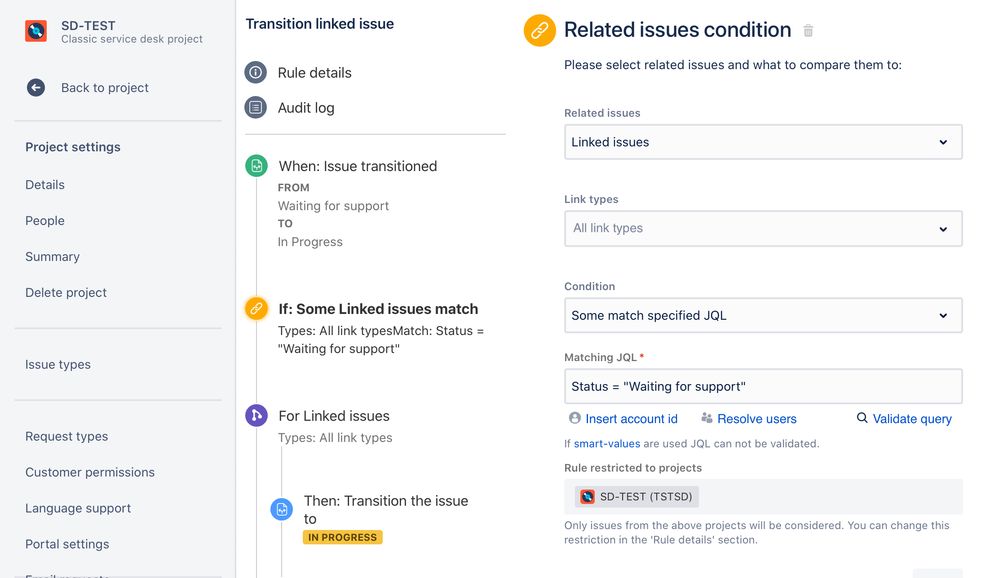

The second screenshot, I am struggling to recreate the
       IF: Some Linked Issues Match        portion of the rule
Could you please expand how you achieved this?

Jack Brickey
July 12, 2020
That is Related issues Condition.

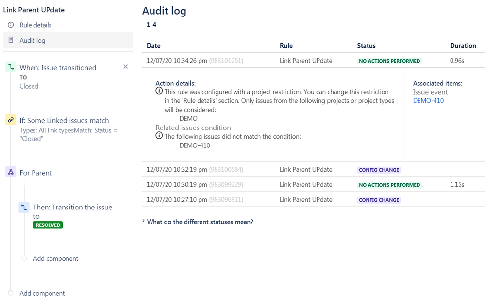

Thanks Jack
The Project automation rule does not seem to work for me.
The parent issue still remains at its current status even after the linked issue as transition all the way through the process.
Below is what I have set up and the audit log shows a message about restrictions, however I cannot see how it would be restricted if the linked issue is within the same project.
Thaks
Dean
Jack Brickey
July 13, 2020
Why are you using “For parent” as the branch? That would be if you were dealing with sub-tasks. If you are dealing with linked issues then you should use the “For linked issues” branch function.
Dean Stearn
July 14, 2020
Thanks for all your help Jack, I selected Parent incorrectly and also spotted another issue that added to my problem.......
