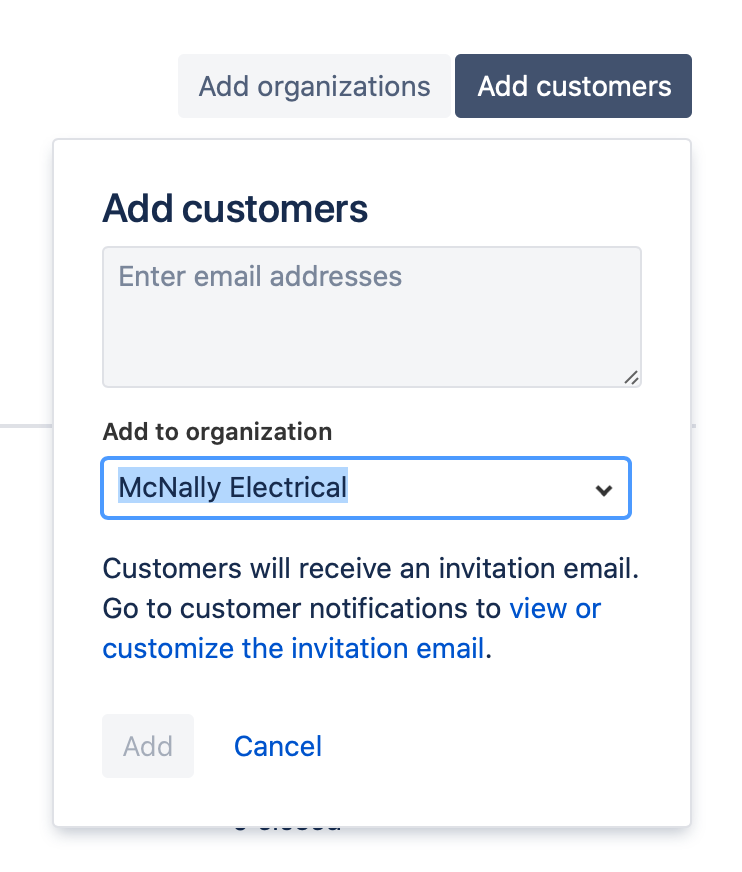

I'm trying to do this too - however when you say "just uncheck the box to send an invitation." this option doesn't exist?Screenshot 2019-11-14 at 09.28.27.png

Daniel Siegel
March 31, 2020
Same problem. How can we fix this?

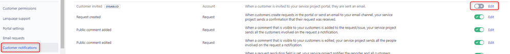

Khalid Tariq
October 15, 2020
Can you not turn off the notification before adding the customer and then enable it again after you are done?

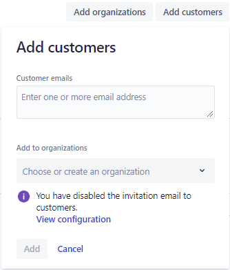

Daniel Triftshaeuser
February 22, 2021
Hello,
what @Khalid Tariq has been suggesting is the best way to solve.
When the notification is deactivate in the project settings
The "Add Custom" function will display this information
This way the customers can be assigned to organizations without additional mails being sent.
Afterwards just reactivate the notification setting if needed.
Best Regards
Daniel
