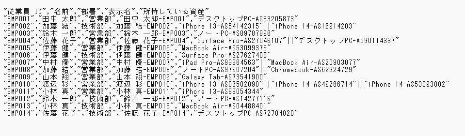

Example CSV:
"Employee ID","Name","Assets"
"EMP002","Kato Yui","iPhone 13-AS54142315||iPhone 14-AS16914203"

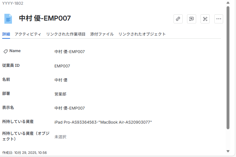

Thank you for your response to my previous message. I also apologize that the attached file ended up being in Japanese.
I tried what you suggested, but I couldn’t make it work. What I’m attaching now is the content of the CSV file and how it appears in the display. It’s related to the object. Could this have caused any issues?

Hi @田中優貴
I assume your import structure is correct, but you need to set the values as follows:
"iPhone 13-AS54142315"||"iPhone 14-AS16914203"
You where missing the quotes for closing the 1st option and opening the 2nd option.

Hi @田中優貴
How is you import mapped in assets, seem like the field is set as a normal field and not as a reference

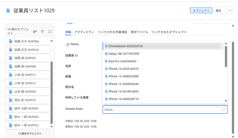

田中優貴
October 29, 2025
I'm sorry for using an image that might be hard to understand.
I'm currently using an Object Type field in the configuration.スクリーンショット 2025-10-30 115657.png
Marc -Devoteam-
October 30, 2025
Hi @田中優貴
So you the attribute Owned Asset is a referenced object to another object type in the same schema or other schema.
On the import, how did you configure this, what are the settings on the import you made?

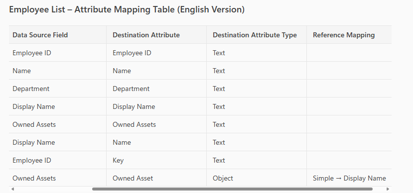

田中優貴
October 30, 2025
Thank you for your support
  • The data source field Owned Assets is mapped to the destination attribute Owned Asset (Object type).
  • Reference mapping is configured to use the Display Name from the asset list (Simple).
  • Object reference is managed in another schema, enabling cross-schema linking for assets.
  • The data source field, the destination attribute, and the referenced Display Name all contain the same value: the asset name.
Marc -Devoteam-
October 31, 2025
The attribute owned assets, what is the cardinality set to?
Can it contain more than "1" referenced object?
田中優貴
November 3, 2025
I’ve set the cardinality to the maximum value.
