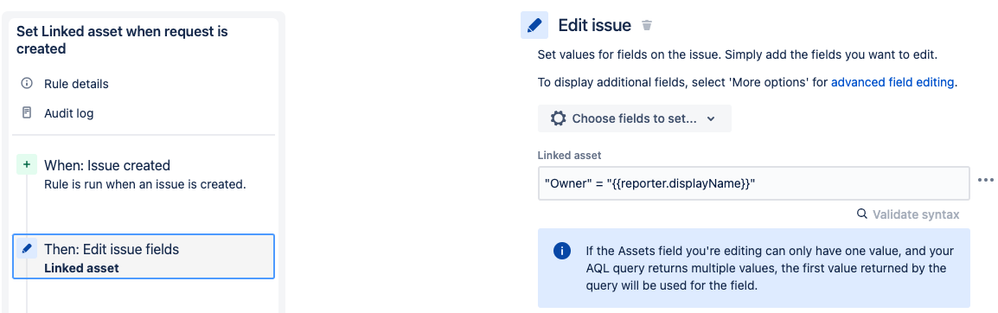

The article you found only applies to Data Center, not Cloud. In Cloud automations are found under Project settings > Automations and have components to lookup Asset objects.
Here is an example where I set an Asset object field for linked assets:
If you go this route the AQL would look something like this for the internal asset field:
objectType = Internal AND "External asset" = {{issue.External asset}}

Thanks for the response. I finished setting up the automation according to your advice. For folks who check this question, this post also helps to understand the solution above better.
https://confluence.atlassian.com/jirakb/auto-populate-the-assets-object-field-based-on-the-reporter-field-of-the-ticket-1116298907.html
