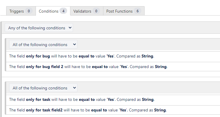

Hi @Wagner Thierry ,
Can you try with or condition between fields mapped to issue type A and fields mapped to issue type B.
You can configure fields for the respective issue types only. Suppose custom field 1 and 2 are for issue type A, then configure that field only to that issue type.
refer below snapshot for example.

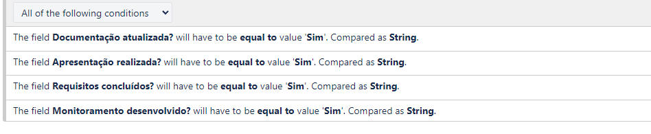

Yeah they are mapped right, but how did you split in two?
Mine look like this:
