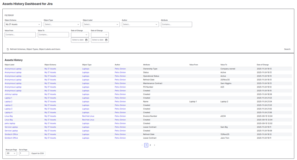

Hi @Christopher Brown ,
If you are open to using apps, you can use Assets History Reporter for Jira , an app released y our team.
You can search your assets by various criteria and see what was changed and by whom. The result is exportable in csv format.
You can later agregate multiple searches in your csv file for Excel analysis.
Regards,
Petru
