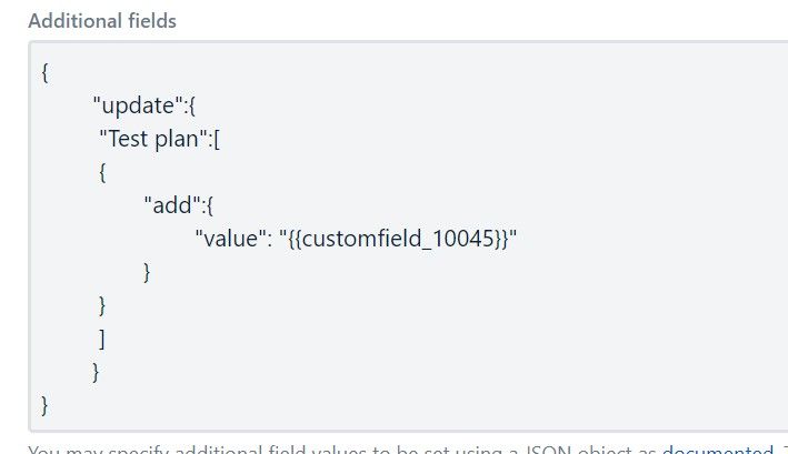

FredYeung
January 20, 2023
Hi Trudy,
Thanks for your reply. I have tried below Advanced Editing feature but failed. Would you share a sample example with me? Many Thanks.
Error message: does not support operation 'add'
Additional fields:
Regards and Thanks,
Fred

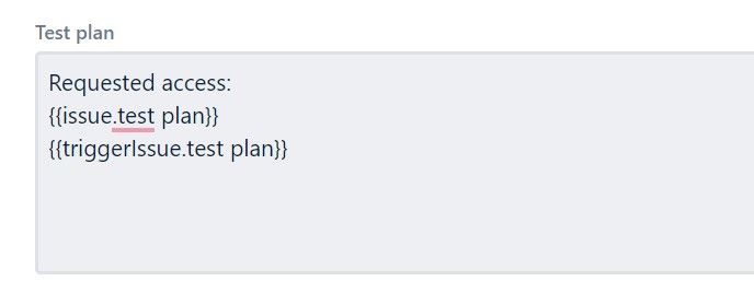

FredYeung
January 20, 2023
Hi Trudy,
I am successfully working on the below setting; thanks for your lead me. Many Thanks.
Result:
Regards and Thanks,
