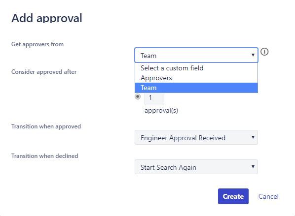

Hi @Ben_Andrews
I had the same problem and find a solution if you still need it.
On the transition before your "approval status", add a postfunction to duplicate the value of the reporter field (or customer custom field) to your approvers field (or approver custom field).
Then the configuration is the same as any approvals setting.

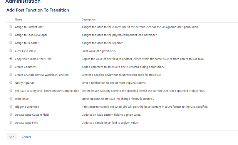

Hello
How can I add this post function, I don't see it in the post functions list when I click on add.
Thank you
Qu3ntin
December 21, 2018
Hi @ABA
It's Copy Value From Other Field

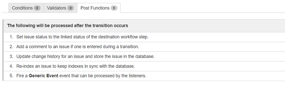

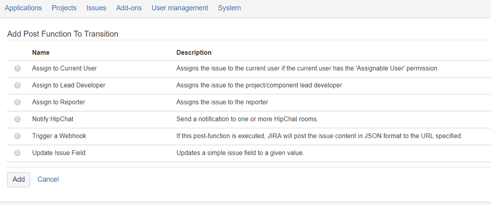

ABA
December 21, 2018
Hi
Thank you for the quick answer, I don't see this options in my list !
2018-12-21 17_01_46-Transition_ Submit quotation to customer - Total.png2018-12-21 17_02_02-Add Post Function To Transition - Total.png

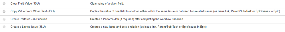

Qu3ntin
December 21, 2018
It seems your are on a Sever version. My screenshot was from cloud version.
You will need JSU for this postfunction.

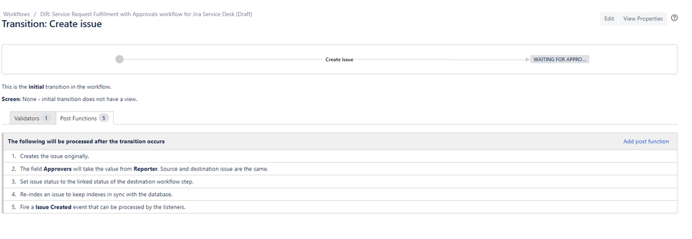

Hi! To set the requester as the approver, set up the "Approver" field as outlined above and then!
go to your workflow
on the create issue transition add a post function
choose "Copy Value From Other Field"
Source Field: Reporter
Destination field: Approver
check Copy within same issue

did you view the links that Yogesh provided? You should be able to do the following:
  1. define a custom field to capture the approvers, e.g. "Customer Approvers"
  2. Configure the field and add in the customer's name that needs to approve
  3. update the workflow to require the approval via the custom field.

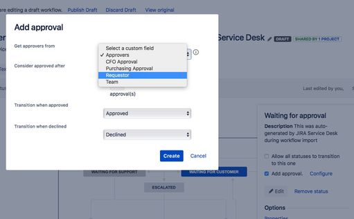

Jack Brickey
June 4, 2018
if you want the Requestor to approve then update the WF and choose Requestor for the appropriate status. If you need a customer other than the requestor then you need to add the specific name(s) to the custom field.
Ben Andrews
June 4, 2018
I don't have the Requester Option?
I can add a custom field called Requester but do not know how to automatically set that field to be the name of the customer/requester.
Jack Brickey
June 4, 2018
my bad. that is a custom field that I created long ago and had forgotten. So forget that. :-(  You will need to define the customer(s) names. I don't know of any other method at this point.
