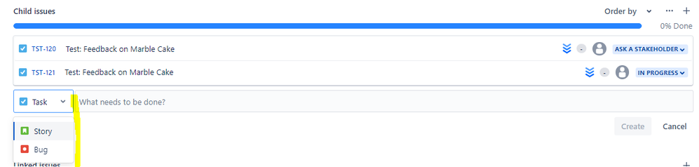

I created a new Issue Type "Request" and would like to add this new type as a child-issue option in the Epic-issue, so that the user has one more issue type option (=Request) to choose from besides the predefined options: task, story and bug:

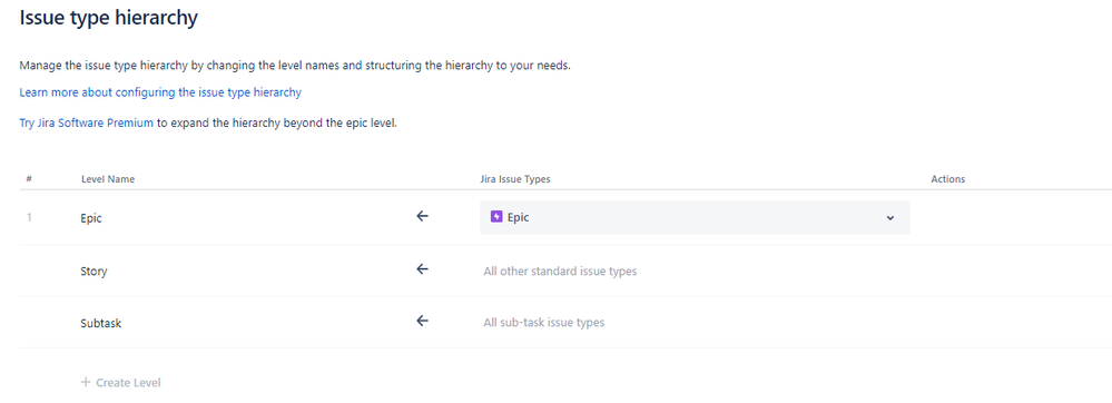

I already checked the "Issue type hierarchy", but this doesn't seem to be the right admin page since it didn't list the types "Bug" and "Task" (which is shown above in the dropdown).
Where is the parent-hierarchy of "Epic" (to its children: Task, Bug, Story) defined, and can it be extended by additional Issue Types?

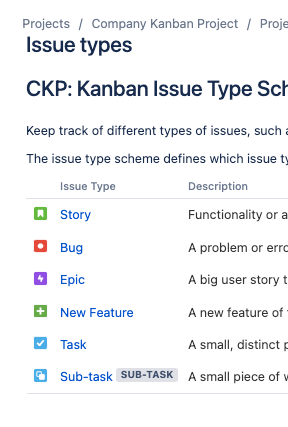

Go to Project Settings > Issues > Type. That should show you a screen similar to this:
If you don't see the Request issue type listed there then you will need to click on the Actions button and select Edit Issue Types, and add the new issue type to this scheme.
Note that if this scheme is used by more than one project, the new issue type will become available in all projects that use the scheme.
This all assumes you have created the Request issue type at the "standard" level, and that you are using a Company Managed project.

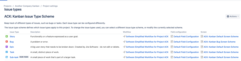

Hi @Trudy Claspill ,
Thanks for the quick response. I already added the new Issue Type to the Issue Type Scheme of my project. But that does not correlate to the Epic hierarchy depicted in my first screenshot.
Just to clarify: my new Issue Type already shows up in the "Create Issue"-Dialog in the Issue Type dropdown (and yes, it shows up in all of our projects that use the same Issue Type scheme), but I need it to be inserted to the Epic-hierarchy (besides Bug, Story, Task), how do I do this or is it even possible? Your answer referred to the Issue Type scheme, which was already solved.

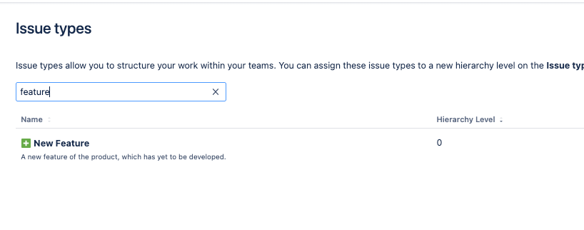

I created a new standard issue type - New Feature at hierarchy level 0.
I did not explicitly add it to the issue hierarchy.
I added it to the Issue Types scheme that is used by the project.
I created a new Epic issue in the project, and I do see the new issue type as an option for the child issues.
