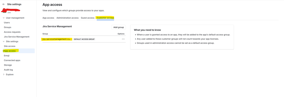

I understand that you are using Atlassian Guard but do you have user provisioning activated?
It depends on what you consider as being an "inactive user". If those users are deactivated from Azure AD, then you must reactivate them from there.
However, if the users are active in Azure AD, you must assign them Customer licenses in JSM and you must make sure that they have Customer project role on the project where the approval process is. One way to do this is to bulk assign them to the default customers group (the name usually starts with "jsm-servicemanagement-customers") and make sure that group provides customer access. For this, you need to go into the Site settings -> App Access -> Customer Access.
Then, if your JSM project is restricted, you need to add the group as a customer on the specific project. If the project is marked as Open, you don't need to do anything else
This way, you will be able to use them in the approval process and such a user will be able to approve a request from the Portal screen. They don't need Backoffice access (agent license) for this.

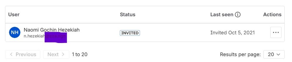

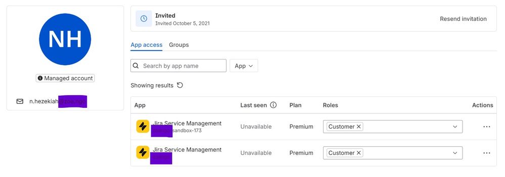

Evert Morren Atlas Admin
November 12, 2025
We have user provisioning activated, the users are active in Azure AD.   The groups are added as cusotmer to a specific project. The user has customer rights, but I cant't find the user as approver.
