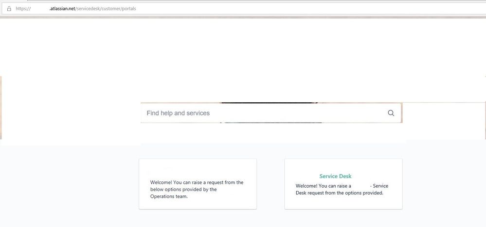

We have a main customer portal that refers as below:-
https://xyz.atlassian.net/servicedesk/customer/portals
When the customer login, on the page to raise a request, he can see all our projects name and to raise the ticket on the project which we do not want him to see the other project name on the same page, I have tried couple of things here tried permission issues, browse project, but all seems to be Ok, if i remove Service desk customer - portal access from the browse project, it will remove the project from the main portal, but then i have problem with that project and no once can send the request on that project also. Need to know how can i setup this. We have almost more than 30 projects, Need help ASAP. as it is kind a urgent. I am attaching the screen shot also for reference.IMAGE MAIN PORTAL.JPG

Hi @Muhammad Bilal ,
please check customers on each project and make sure that just desired customers are in that list. Moreover make sure that each project has Customers my team adds to the project (default). https://confluence.atlassian.com/servicedeskcloud/project-customer-permissions-954239155.html
on the customer portal, customer will show all projects in which he is able to raise tickets to. If you want to show just particular projects you should limit access to all the others by using customer permission as previously described.
At permission scheme level, ususally you have create issue permission associated to Service desk customer - portal access that is a best practice. So please, ensure that just desired customers have been defined as customer per project basis.
Fabio
permission scheme is correct so you don't need to make any update on it. Just users defined as customer can view and access the related project on the portal side.
