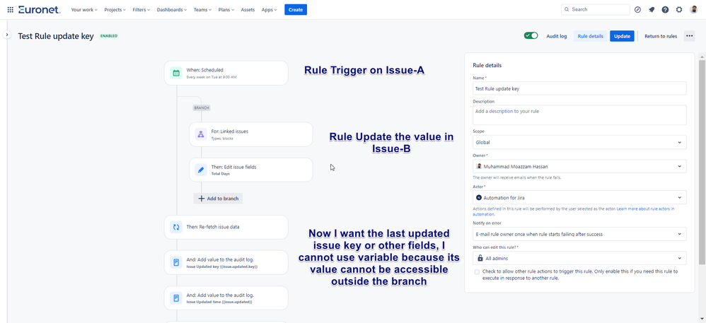

Hi,
I am editing my issues via branch rule now after the branch I want to access the issue which is last update by this rule. Like there is an option like last created issue by this rule as same I want the issue key of the issue which is last updated by this rule.

Yes sure you are right.
PFA

Thank you for sharing. What will you do with that key now? Can you not just add an action after the Edit Issue?
Muhammad Moazzam Hassan
February 8, 2024
I will lookup issue on the behalf of that issue key and than update then use their data.

Basically what I am trying to achieve is to update the chain of Block issues,
Like A Blocks B blocks C Blocks D and carry on till 20, but there is a limitation in Jira that the Automation rule will stop after 10 Execution if it is calling itself, when the Due Date change on Issue A then it will update the start date and due date of issue B then C,D... and till the last one, but rule stops after 10th execution.
So I am trying to update 2 issues in one go, Like.
Start and Due Date change of B then it will update C via branch then pass the C issue key outside branch then I will create another branch on the basis of the C issue key and Update D,
By doing this configuration I can update the chain of 20 Issues.

But now I have found a solution, the variable value can be accessible outside branch and it can works for me, I think the automation rules has updated because few days back I cannot access the variable value outside the branch.
