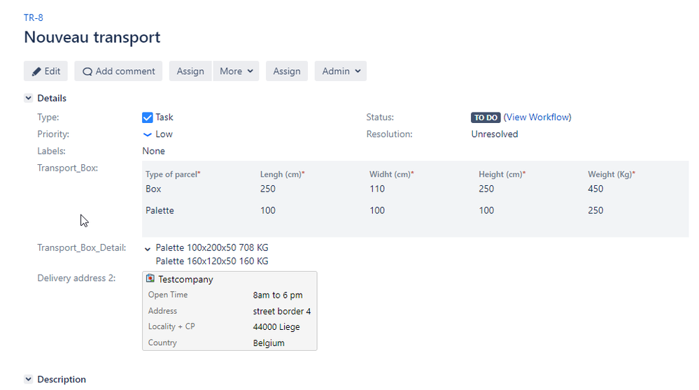

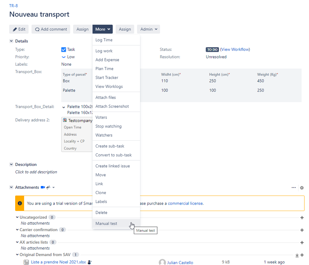

Here an issue example, and i would to get back value from Jira automation for the insight attribute Pick-Up Address. I want to get back Name, Address, Locality + CP

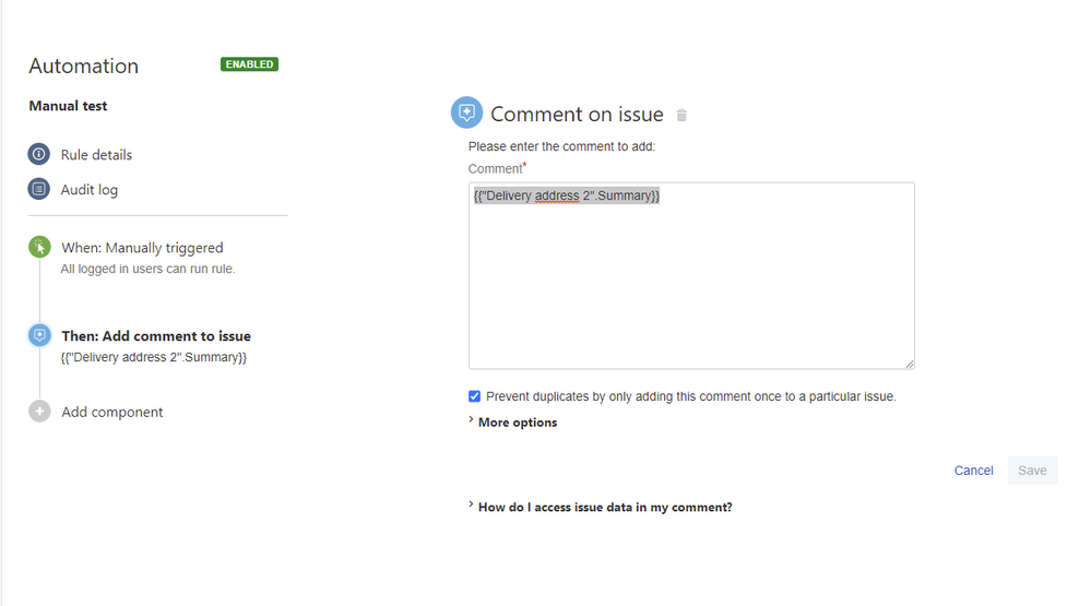

usually to test smart-value, i create a manual trigger on Jira Automation to test it and check the comment wrote to see the value but actually nothing works

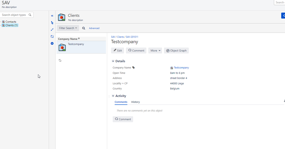

here the object in Insight:

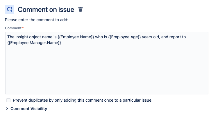

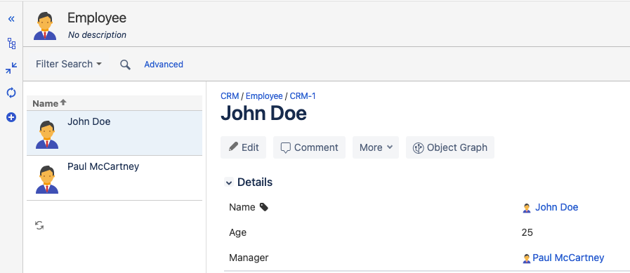

You have to use the actual object, though. In your case, Clients. See the example below.
I've got an Employee object with an attribute object Manager for the CRM schema, which points to Employee in this case.

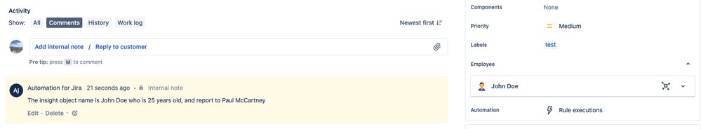

For the automation, as an example, I'm adding a comment to the issue using the smart values.
Comment on the issue based on smart values.
I hope that helps.

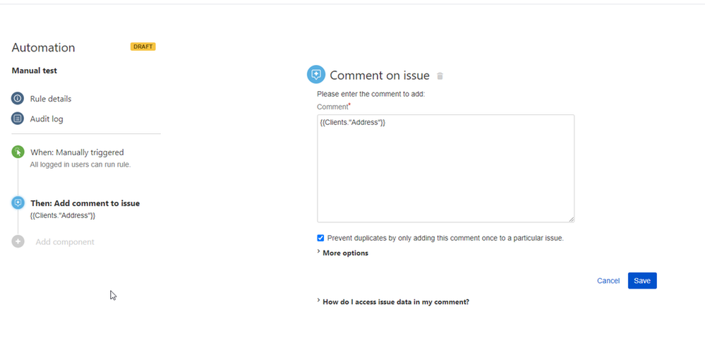

I tested {{Clients.("Address")}} (because the attribute is just text but still not working.
If i use {{"Delivery address".Summary}} i have the Name of the object but how have his attribute?
{{"Delivery address".Address}} doesn't return anything.

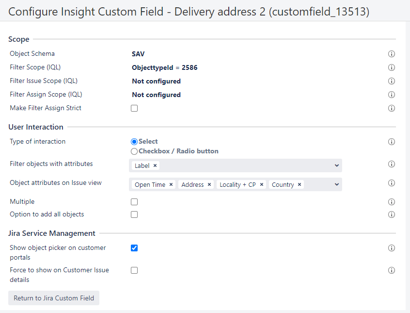

Clients should be your insight object custom field, where you need to set the insight objects field configuration by selecting the schema and scope to ensure your smart values won't find conflicting objects/attributes to fetch. In this case, if the Insight object is Clients, ensure you scope your custom field to Clients object. Once you review that, you can do {{Clients.Address}}. The same applies to all other fields. If, even though you can't make it work, which you probably will, I suggest you share your step in more detail (if you're comfortable doing so):
  • Custom field context (Insight objects field configuration)
  • Schema, Object and object attributes (type, type value)
  • Automation (smart values section)
The automation, if it's triggered manually or based on issue triggers/events, shouldn't change the acton results you're trying to achieve in this case.

i created another Schema for the test to avoid to show sensitive data.  I created a new Insight custom field "Delivery Address 2"
{{Clients."Address"}} still not working. The target is to extract the value "street border 4" of "Address" with Jira Automation.
I will share with you all information :
2022-02-10 15_42_17-Insight - AF Jira.png2022-02-10 15_43_01-Insight - AF Jira.png2022-02-10 15_43_14-[TR-8] Nouveau transport - AF Jira.png2022-02-10 15_44_06-Window.png2022-02-10 15_44_11-[TR-8] Nouveau transport - AF Jira.png2022-02-10 15_44_57-Window.png
Is it all you need to troubleshoot? Thank you very much Ivan.
Ivan Lima
February 10, 2022
Assuming the filter scope has the correct Id, your CF is "Delivery address 2", and you have already defined the "Delivery address 2" scope as your Clients' Insight object, so your smart values should point to it. Try replacing your smart value for the one below. You should be able to get that working now.
{{"Delivery address 2".Address}}

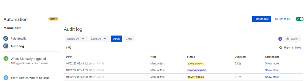

I tested {{"Delivery address 2".Address}} in the manual trigger and still empty :(.

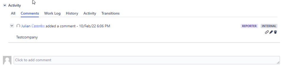

For information with {{"Delivery address 2".Summary}} it's working, i have the name

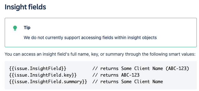

Hey, @Julian from AF, I tested Jira Cloud but found this for Server/DC. "We do not currently support accessing fields within insight objects." Therefore, insight fields' full name, key and summary.
https://confluence.atlassian.com/automation/smart-values-993924860.html
Julian from AF
February 14, 2022
oh ok...  i need to create for each value others text field to extract it in the workflow in this case ;(. Ok thank you !
